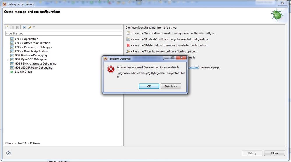

profprogrammer
I use KSDK. Kinetis 3.0.
When i start Debug configuration. i get misteke.

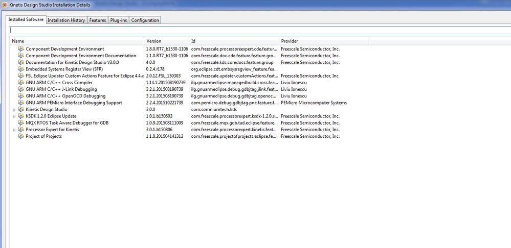

My vertion soft/

ivadorazinova
Hello Prof,
please, just for confirmation, do you follow the steps mentioned bellow?
Unable to Debug after KDS Update
is needed to re-write files in plugin folder:
  1. Close KDS/Eclipse
  2. Download the attached 'plugins.zip'
  3. Extract the two plugins in that zip file to the 'plugins' subfolder of your installation folder (C:\freescale\kds_v3.0.0\eclipse\plugins)
  4. Confirm to replace the original files
  5. Restart KDS/Eclipse. Segger J-Link debugging is possible again.
Hope this solve your issue.
