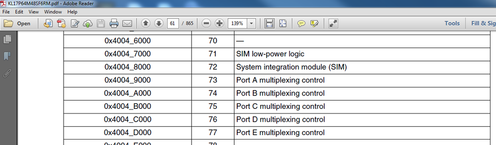

While looking at the Memory Map for KL17Z64VFM4 in the 1.3 and 2.0 SDK's (MKL17Z644.h) I noticed that the memory map listed for the Ports does not match the memory map provided in the datasheet (Document Number: KL17P64M48SF2).  For example Datasheet indicates PORTA base as 0x4004C000 while the SDK lists it as 0x40049000.  I'm assuming that the SDK is correct for the micro, but wanted to verify before I started my development.

Hi, Artur,
I think the data sheet is wrong. I have checked the RM of Kl17, the PORTA multiplexing control base register address is 0x4004_9000.
I copy it here.
hope it can help you.
