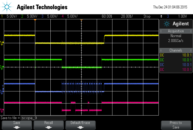

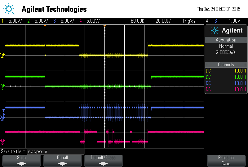

Hi:
I am working on a custom board equipped with K66 MCU(120MHz, and 60MHz bus clock), serial Flash, Ethernet switch, and other peripherals. The purpose of serial Flash is just for data storage. The Ethernet switch is configurable through SPI interface. Both device are on SPI1 bus and I have successfully read both device ID at 500KHz baud. However I have Ethernet problem after I have some data write to serial flash. Investigate problem more detail, I found whenever SPI initialization DSPI_DRV_MasterInit() is called, the un-selected PCS will keep asserted even during data transferring. I am not sure if I utilize KSDK properly. Please let me know if you have any idea. Thank you very much.
Read serial flash ID with PCS0
yellow: PCS0 (PTB10)
green: PCS1 (PTB9)
blue: SCK (PTB11)
pink: SOUT (PTB16)
Read Ethernet switch ID with PCS1
yellow: PCS0
green: PCS1
blue: SCK
pink: SOUT

xiangjun_rong
Hi, Peter,
I have not idea unless you use debugger.  As you know that the code use the interrupt mechanism to transfer data. I suggest you use debugger and set a break point in ISR and check the SPIx_TXFRn register which is a copy of the SPIx_PUSHR.
Hope it can help you.
Xiangjun Rong

xiangjun_rong
Hi, Peter,
Regarding your issue that both PCS0 and PCS1 pins are driven low when you transfer SPI data, of course, it is a wrong timing, which may results in the chip damage because of MISO pin conflicting.
Regarding the reason, I suspect that you set both the PCS0 and PCS1 bits in SPIx_PUSHR(I mean the bit16 and bit17 in SPIx_PUSHR register), if you set both PCS0 and PCS1 bits when you write SPIx_PUSHR to launch a SPI transferring process, both PCS0 and PCS1 will be driven to low. Pls set only PCS0 or PCS1 bits rather than both when you write the SPIx_PUSHR register.
Xiangjun Rong

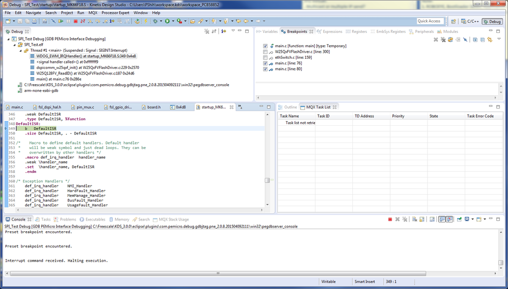

petershih
Hi Xiangjun:
I just tried calling CLOCK_SYS_EnableSpiClock(1); before SPI1_PUSHR &= ~(0x3F0000); The system doesn't trapped into system fault, but It is still not working. I got the same result as the before. Hope you have better idea. Thanks!
4,479 Views
petershih
Hi Xiangjun:
I do have code for SPI1 as you hint, but not able to clear the register and the system jump to system fault. However, you probably have good guess; since the SPI clock is enabled in DSPI_DRV_MasterInit(), I am not able to write to the PUSHR register no matter how you tried. Probably the only way is modify the SDK source code, use GPIO as PCS signal, or turn on clock and clear register before calling DSPI_DRV_MasterInit(). Thanks your support. If you have any better idea, please let me know. Thanks!
