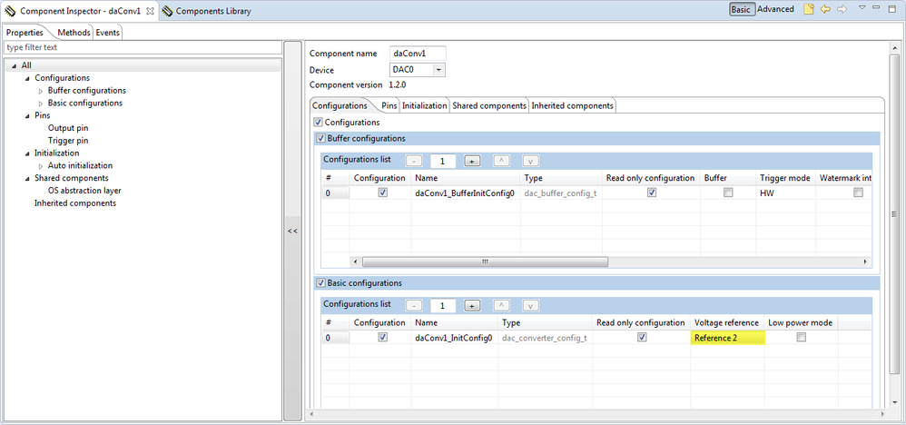

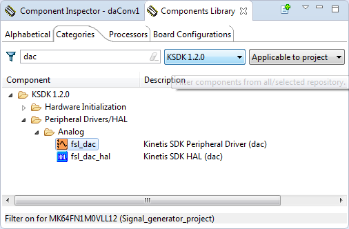

  • adding analog component fsl_dac peripheral driver to project
  • setting Voltage reference - Reference 2 for dac component (daConv1:fsl_dac)

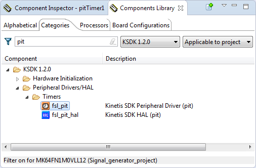

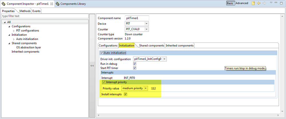

  • adding timer component fsl_pit peripheral driver to project

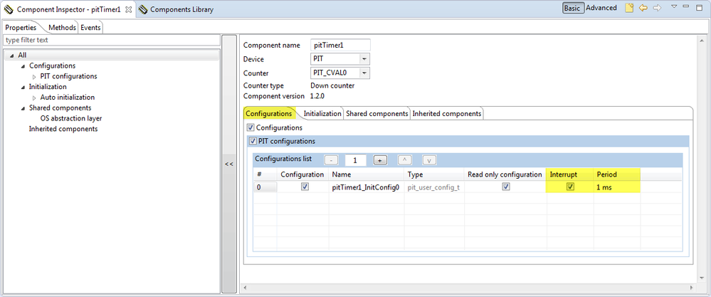

  • setting period on 1 ms and enabling interrupts for timer component (pitTimer1:fsl_pit)

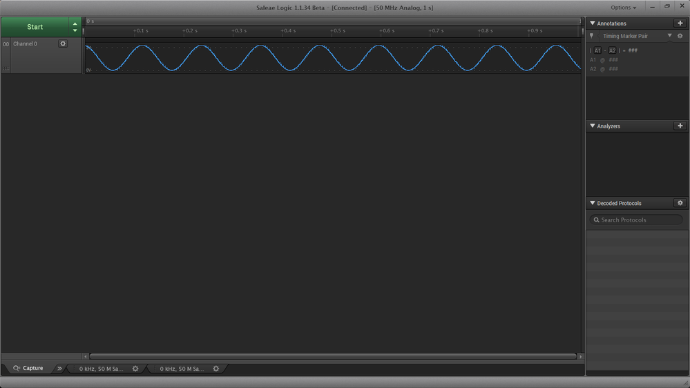

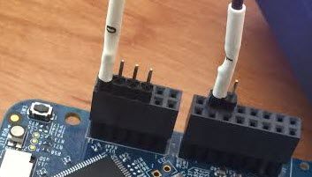

  • FRDM-K64F with SALEAE
  • sinusoidal output

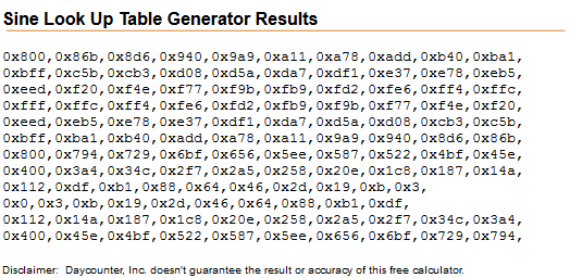

How do you make your buffer to generate a signal? I use EXCEL to do so, but, is there any other way to do it?
Jordan c:
Hello Jordan,

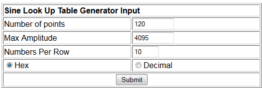

thank you for the question, I forget mentioned it.
For getting these values you can count it :-) or put them to Sine Generator with values for max amplitude.
E.g. you can use any on-line sine generator, like Sine Look Up Table Generator Calculator and fill the values with
where Number of points are array values, for dac_buffer[DAC_TEST_BUFF_SIZE],
Max amplitude is (2^12) -1 and Number Per Row is value for showing results.
After that you get these values: (I see there is a small difference between values, but it can be caused by rounding)
I hope it helps you,
Iva
