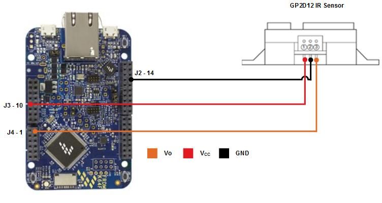

The application’s schematic diagram is shown in the following figure
Figure 2. Schematic Diagram
The required electrical connections to implement the application are explained below
Table 1. Electrical connections

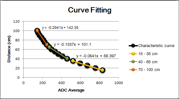

The implemented algorithm to calculate the distance is based on the division of the characteristic curve of the IR Sensor’s behavior in three different sections in order to approximate it to a linear behavior. Each line was generated from two different points. The first line is used when the uiAvgAdc value is between 520 and 840 (15 - 35 cm). The second one, for an uiAvgAdc value higher than 260 and lower than 519 (40 - 65 cm). And the last one, for uiAvgAdc values between 130 and 259 (70 - 100 cm). Depending on the calculated uiAvgAdc value, the slope (dwm) and the intersection with the y axis (dwb) change for each line.
  In order to make the demo compatible with different microcontrollers and IDEs, it was necessary to avoid the use of float variables to calculate the distance, so that the result could be printed on a console without problems. The real values of the slopes and intersections with the y-axis for each line were multiplied by 10000. After getting sdwCurrentDistance value it is divided into integers and tenths; to get the integers at g_dwDistanceIntegers, the current distance is divided by 10000 and the corresponding fraction for tenths is stored in g_dwDistanceTenths. As a result, the current distance value is printed combining the integers and tenths variables, avoiding the use of a float variable.
     The following graphic shows the characteristic curve and the three lines in which it was divided
Figure 4. Characteristic curve’s graphic

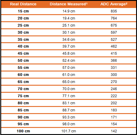

The application test’s results are shown in the following table
1 The error for the Distance Measured values is approximately ± 0.5 cm
2 The ADC Average values have an error of approximately ± 5 units
Table 2. Test’s Results

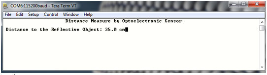

   Once the project is opened in one of the supported IDEs, remember to build the KSDK library before building the project, if it was located at the right place no errors should appear, start a debug session and run the demo. The results of the distance measurement will be shown by UART on a console (use 115 200 as Baud rate) and at FreeMASTER, just as in the following example where the reflective object was located at 35 cm from the IR sensor:
Figure 5. Example of the distance measured being shown in a console

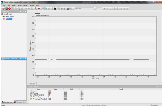

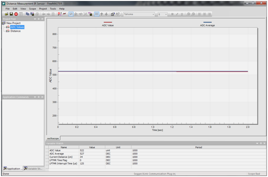

Figure 6. Example of the ADC Values obtained from the IR sensor monitored with FreeMASTER
Figure 7. Example of the distance measured results at FreeMASTER

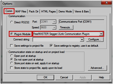

FreeMASTER configuration
For visualizing the application’s result on FreeMASTER it is necessary to configure the corresponding type of connection for the FRDM-K64F:
1. Open FreeMaster.
2. Go to File/Open Project.
3. Open the Distance Measurement IR Sensor project from <KSDK_install_dir>/demos/distance_measure_IRsensor/ FreeMaster.
4. Go to Project/Options.
5. On the Comm tab, make sure the option ‘Plug-in Module’ is marked and select the corresponding type of connection.
Figure 8. Corresponding configurations FRDM-K64F’s connection at FreeMASTER

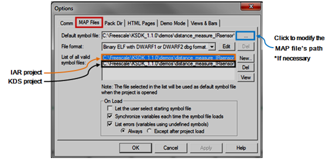

It is also necessary to select the corresponding MAP file for the IDE in which will be tested the demo, so:
6.  Go to the MAP Files tab.
7.  Select the MAP File for the IAR or the KDS project.
*Make sure that the default path matches with the one where is located the MAP file of the demo at your PC. If not, you can modify the path by clicking on the ‘…’ button (see Figure 9) and selecting the correct path to the MAP file:
  • <KSDK_install_dir>/demos/distance_measure_IRsensor/iar/frdmk64f/debug/distance_measure_IRsensor_frdmk64f.out
  • <KSDK_install_dir>/demos/distance_measure_IRsensor/kds/frdmk64f/Debug/distance_measure_IRsensor_frdmk64f.elf
8.  Click on ‘OK’ to save the changes.
Figure 9. Selection of the MAP File for each IDE supported by the demo
