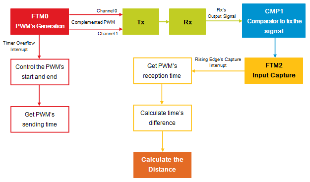

The following figure shows the application’s block diagram
Figure 1. Block Diagram

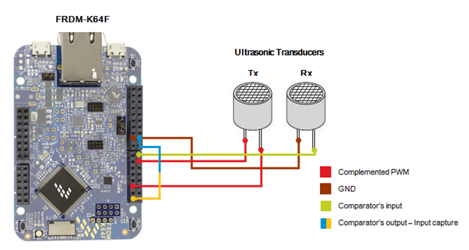

     The schematic diagram for the application is shown in the following figure
Figure 2. Schematic Diagram

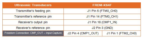

     The electrical connections needed to implement the demo are presented by this table
Table 1. Electrical connections

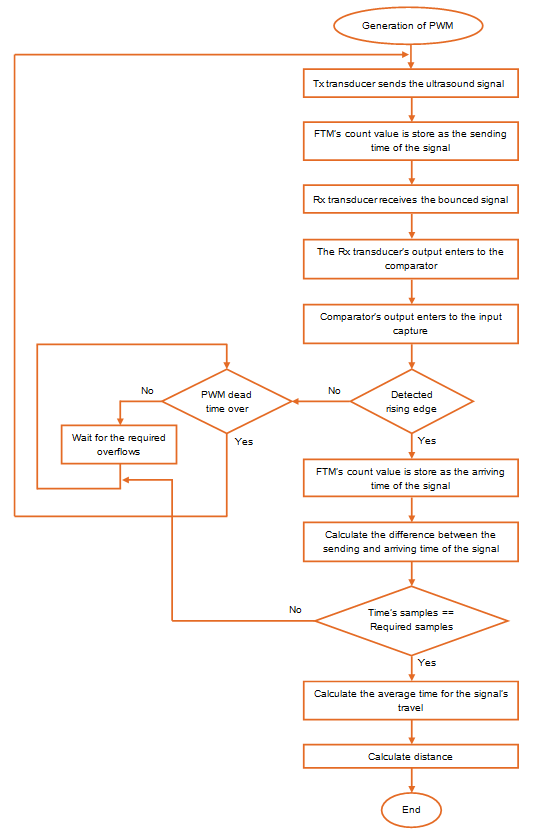

     The application’s flow diagram is displayed by the following figure
Figure 3. Flow Diagram for Distance’s Calculation

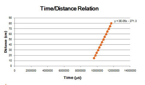

void vfnGetCurrentDistance(void) {     static uint64_t dwDistance = 0;     uint8_t b_m = 3;     uint32_t w_b = 27130000;     uint32_t w_FixedPointAux = 100000;     uint16_t swTimeBase = 265;          // 265ns per FTM2 Count          wAverageTravelTime >>= 1;        wAverageTravelTime = (wAverageTravelTime*swTimeBase);          dwDistance = (wAverageTravelTime * w_FixedPointAux);     dwDistance = (dwDistance * b_m);     dwDistance = (dwDistance / w_FixedPointAux);     dwDistance = (dwDistance - w_b);          bDistanceIntegers = (dwDistance / w_FixedPointAux);       bDistanceUnits = (dwDistance % w_FixedPointAux);     bDistanceUnits = (bDistanceUnits / 10);          bDistanceReadyFlag = 1; }
The distance calculation is based on the linear behavior of the transducers’ response. Some samples of the signal’s travel time were taken for distances from 15 to 80 cm and according to that data, it was calculated a linear equation that describes the calculated travel time in function of the distance to the reflective object (See Figure 4 below).
After getting the time difference, in FTM2 counts, between the departure and the arriving time of the signal, it was necessary to divide that number of counts, because that time difference corresponds to the travel of the signal to the reflective object and back to the transducers. Furthermore, it was required to convert those counts to real time, and according to the configurations of the FTM2, each of its counts was equal to 265 ns.
The rest of the algorithm consists just on the use of the linear equation the travel time as variable, multiplying by the corresponding slope (b_m) and adding the intersection with the y-axis (w_b).
The real values of the slope and the intersection with the y-axis were fixed in order to avoid the use of float variables.
The following graphic shows the characteristic linear behavior of the relation between the signal’s travel time and the distance from the transducers to the reflective object
Figure 4. Characteristic curve’s graphic

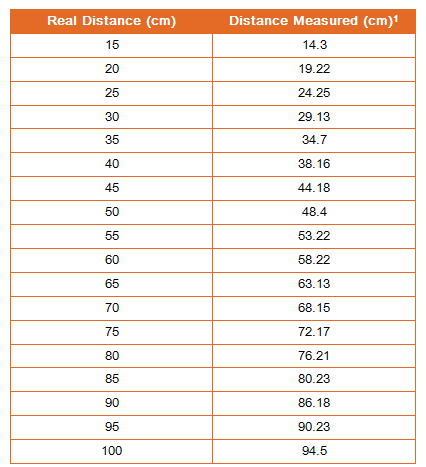

The application test’s results are shown in the following table
1The error for the Distance Measured is approximately ± 2 cm for short distances and ± 5 cm for the longer ones
Table 2. Test’s Results

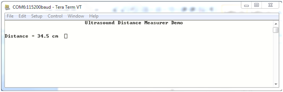

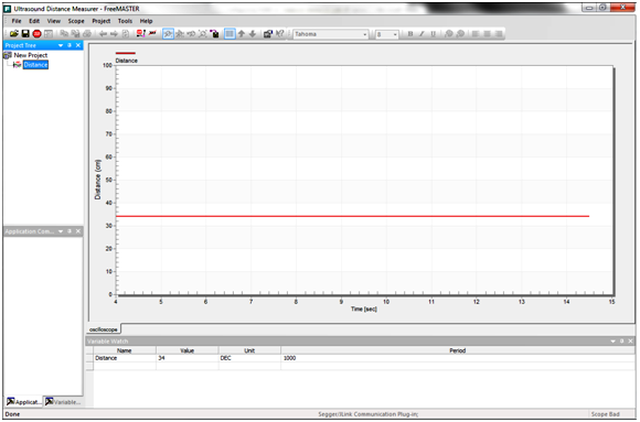

Figure 5. Example of the distance measured being shown in a console
Figure 6. Example of the distance measure results at FreeMASTER

For visualizing the application’s result on FreeMASTER it is necessary to configure the corresponding type of connection for the FRDM-K64F:
          1. Open FreeMaster.
          2. Go to File/Open Project.
          3. Open the Ultrasonic Distance Measurer project from <KSDK_install_dir>/demos/ultrasonic_distance_measurer/ FreeMaster.

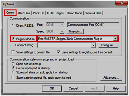

          4. Go to Project/Options.
       On the Comm tab, make sure the option ‘Plug-in Module’ is marked and select the corresponding type of connection.
Figure 7. Corresponding configurations FRDM-K64F’s connection at FreeMASTER

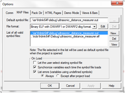

It is also necessary to select the corresponding MAP file for the IDE in which will be tested the demo, so:
          1. Go to the MAP Files tab.
          2. Select the MAP File for the IAR or the KDS project.
*Make sure that the default path matches with the one where is located the MAP file of the demo at your PC. If not, you can modify the path by clicking on the ‘…’ button (see Figure and selecting the correct path to the MAP file:
    • <KSDK_install_dir>/demos/ultrasonic_distance_measurer/iar/frdmk64f/debug/ultrasonic_distance_measurer_frdmk64f.out
    • <KSDK_install_dir>/demos/ultrasonic_distance_measurer/kds/frdmk64f/Debug/ultrasonic_distance_measurer_frdmk64f.elf
  Click on ‘OK’ to save the changes.
Figure 8. Selection of the MAP File for each IDE supported by the demo
