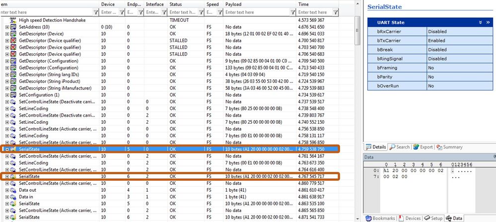

An easier way to create your own CDC + CDC composite device would be to duplicate each CDC function and variable and use both CDC instances separetly. Attach you will find some files from a CDC + CDC basic example which uses this structure and it is working fine in Linux (In windows, It is necessary to use an specific driver to handle this CDC + CDC composite device correctly, so I tested this example on Linux and it worked very well, also i am attaching an image that shows how both CDC instaces are being used without any problem, this example wis based from CDC + MSD example so I used a MACRO to swith between these two configurations).
Next capture shows how both CDC instances are sending configuration settings in their INT endpoint:

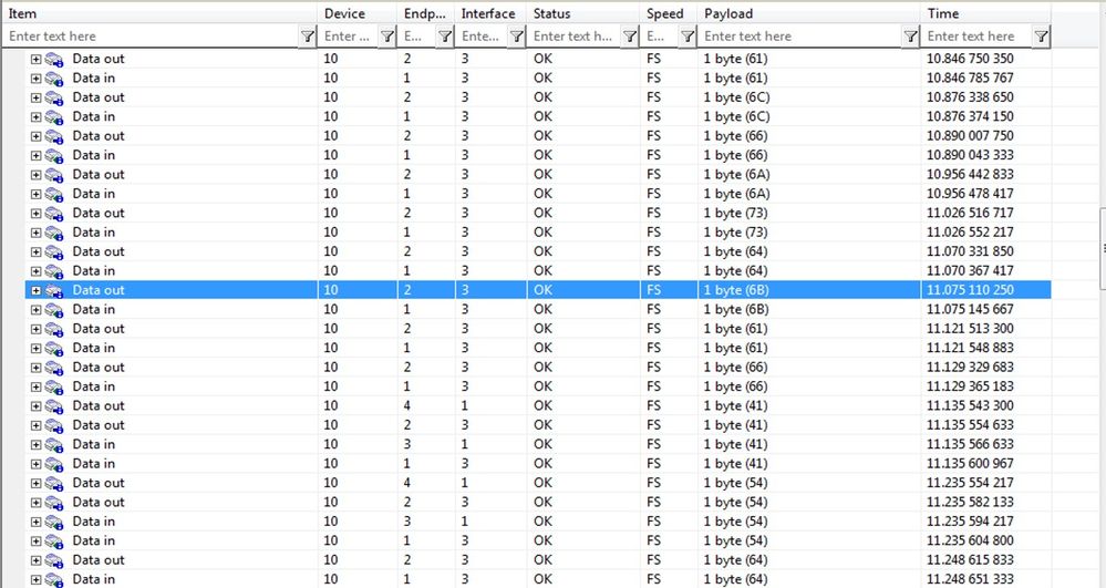

Also, look how both instances are being used at the same time (look how different endpoint from interfaces 1 and 3 are used, rememer that interfaces 0 and 2 are for interrupt endpoints):
