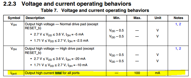

Hi neilporven​, I stumbled across your post and was interested in this LCD question.  Are you trying to leverage some sort of library that might be available for driving the LCD?  If you are basically going to be controlling the pins yourself, then the KL46P datasheet shows that the pins used for the LCD are also GPIOs, so if you configure them for ALT2 you should be able to use them to drive the LEDs.
http://www.mouser.com/ds/2/302/KL46P121M48SF4-783099.pdf
It looks like the KL46P can source 25mA max per pin, but I believe this is the limiting factor:
So if you need more than 3mA per segment, you'll probably have to go with an external driver.
