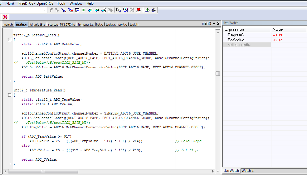

gsmgbl
Hi Xiangjun,
Please see my functions below. I do the ADC_Init in the main at the beginning, then I run my battlvl_read() and temperature_read() in my other task alternatively. I configured my reference voltage source to Valt, I also tried to connect my Vref to VDD as well. But my temperature read became negative value with the taskdelay. See result in the images.

With time delay, ADC value reads properly on both functions.
Without the time delay, the temperature read became negative.
Please advise. Thank you.
