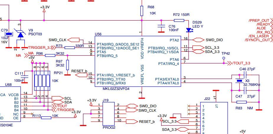

Hi, I'm working with a Kl02 and I'm trying to read an ADC channel but always I read random values. I've been working with different codes and ways but the mistake continues and I can't figure out the problem.
The uC is the MKL02Z32VFG4. QFN 16
I'm trying to read values from the port PTB0 -> ADC0 Channel 6  [ PIN 8 ]
To verify the correct configuration of the ADC peripheral I'm reading form other channel in this case I'm usign the port  PTB5 -> ADC0 Channel  1 [PIN 13] . This channel works perfectly and I can read right values.
This is my schematic. In the PIN labeled as TRIGGER_3.3 I can read perfectly the ADC value. But the PIN labeled as MA give me always random values.

Hi, Antoni,
As JingJing said, the ADC0_SE6(PTB0) corresponds AD9, ADCH should be 9 instead of 6, I have tested on my FRDM-KL02Z board, I can get correct result with the code by testing the PTB0 pin(pin6 of J7 on FRDM-KL02Z board):
