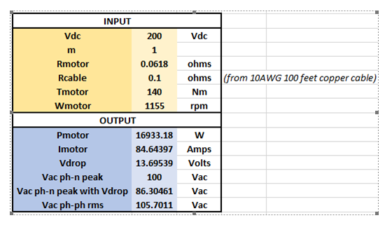

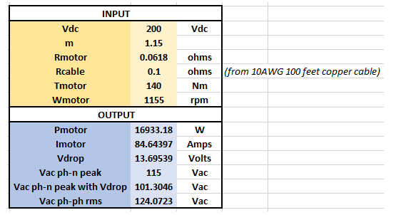

This is a quick analysis of what the system should be able to provide at 200V:
I did a fast analysis of the voltage drop in the resistor path to the motor and the converter should be able to provide around 124Vac ph-ph rms at 200Vdc using max modulation index. Therefore, it should be able to operate 140Nm at 1155 rpm, which would require around 115Vac ph-ph rms.
Instead, if we don’t apply common mode voltage in the modulation to get maximum modulation index we cannot provide the required 115 Vac ph-ph rms and we would need to reduce speed until around 1050 rpm (according to the calculation).
On my opinion, what I would check is if we are providing and defining properly the modulation index by trendering all modulation parameters and converter output.

Hey Adam, the motor is rated at 200V at 2000RPM. 101.3046V should be around 1000RPM. Our system should be able to supply 124V at 140Nm at 1155 RPM at 200V DC Bus - Only 115V would be required to drive the motor at this load. However, we are losing sync at 200V DC Bus. It does not seem we have enough voltage. I am seeing the SVPWM going into the overmodulation states. I am also seeing 130Vrms on the scope at 200VDC Bus 140Nm of load on all three phases, so it seems to me overmodulation is working. Maybe our calculations are incorrect and we need more voltage.
