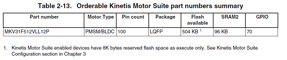

I've  bought KV31F512 but it isn`t working with KMS.
Is there a any KV31F that is sold without the KMS feature?

I can answer you question with a quick look in the KV31 Reference Manual.(Tables 2-12 and 2-13). At the current time the only MKVxx devices that support KMS are the ones with a P suffix. That means if you don't have a part with the P suffix it will not work with KMS.
So if you have a non-KMS enabled KV31 it will not work with KMS.

joãopaulo
Hello Philip,
I've bought FRDM-KV31 but it's not working with KMS because I did an mass erase..
Then I bought some KV31F512 and soldered it at  FRDM-KV31 but did not worked either.
So I realised that there wasn't the P suffix.
What should I do now?
Is there any representant of NXP in Brazil that can reflash these uC?

philip_drake
I'm sorry you are having this problem. I'm glad you have the skills to do the chip replacement.
We cannot support the reprogramming of boards unless there was a manufacturing defect (such as you received a FRDM board with the MBED OpenSDA firware).
The best thing to do is to again order the KV31, but get the one with P suffice, and do the replacement.
