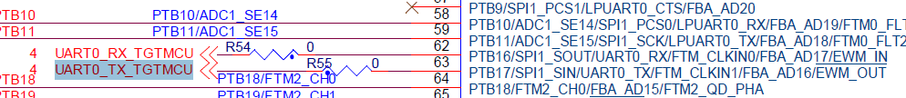

Hi everyone,
I have been using KMS 1.2 succesfully with my FRDM-KV31 and also using the generated code in MCUXPresso for my own application.
However, I have now my custom board, using KV31, that I program with my PEMicro Multilink FX and it turns out that I cannot use KMS GUI with the programmer. Is there a way to use it? What would be a workaround to set the parameters?
Thanks!

PedroCastro
Hey Philip, thanks for your reply!
Here is what I did:
I used an frdm-kv31f as a SWD programmer. I tested uploading a program through MCUXPresso and also loading applications from the KMS interface. However, the serial communication does not work. My board uses PTA14 and PTA15 as UART0. The default pins used by the generated code from KMS are PTB16 and 17. I tried to modify these settings in saved projects by hand and upload the new firmware, but once again unsuccessfully. Do you have any other suggestions?

philip_drake
The UART connections change from the default pin to alternate pins are mentioned in the Adapting KMS for Custom Hardware.  However the steps you need to take to make this change are left to your own skills. I have published on another post these steps linked here.   Please review these steps and you should be able to get it to work.
