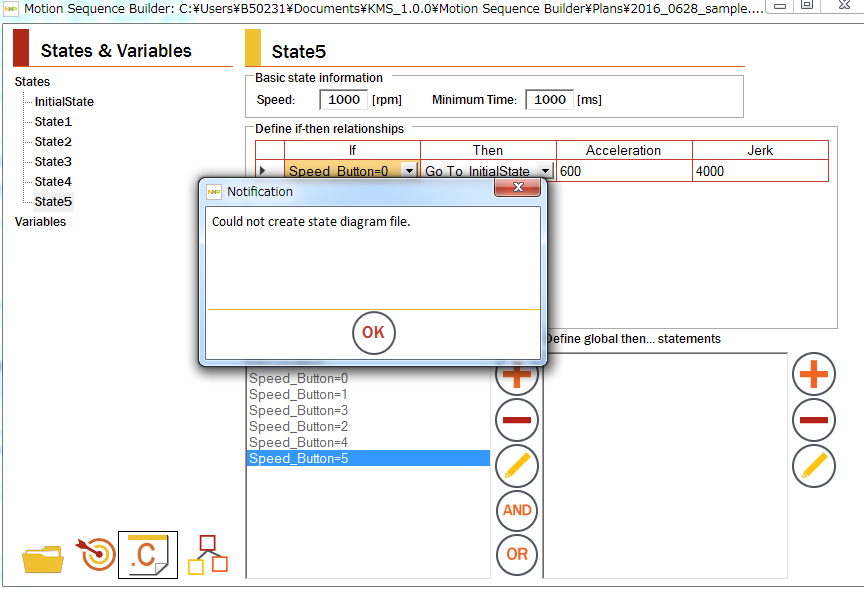

I'm trying to develop sample project.
Then I got an error as following picture.
The notification occurs after save the sequence builder project.
How do I fix the notification?
I re-checked the sequence "if-then relationships", but the notification is not cleared.

b50231katsuhiro
Hi Adam, Iva
I think it was caused by using some numeral in file name.
After remove numeral, the issue is not reproduced.

linestream-adam
Senior Contributor I
We did some additional looking into this and our quick assessment is that using underscores in the filename for Motion Sequence Builder causes issues with the tool used to generate the diagram.  Try to save your file without the underscores and special characters and try it again.  We are continuing to investigate this.
Hope that helps.

b50231katsuhiro
Hi Adam
I re-tried to remove underscore the builder projects. However the issue is not  solved.
Don't you reproduce the issue?

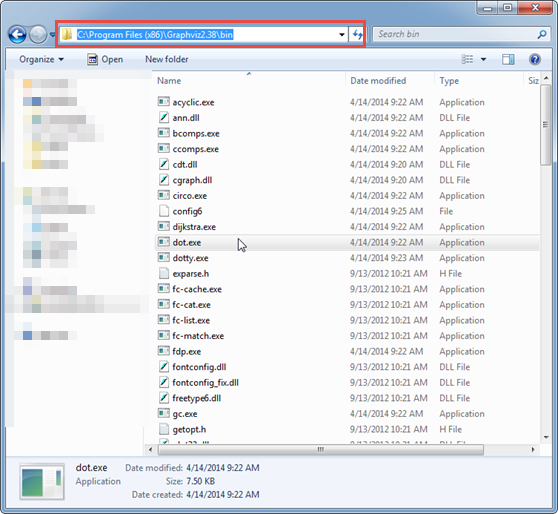

ivadorazinova
At the moment I received the hint from system architect.
Please, are you sure that Graphviz is installed to the location specified in the image bellow and that the highlighted executable is present?
Please let me know, if you solve the issue.
Have a nice day!
Iva

b50231katsuhiro
Hi Iva
>what did you select for your application? Freedom/High Voltage/TWR, Sensored Position/Sensorless Velocity/SensoredVelocity,  PMSM?
Board: Freedom
Motor: Sensorless Velocity PMSM
Yes, it was already installed to the location.

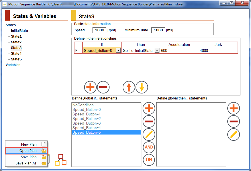

ivadorazinova
I tried to configure it according to your specifications and it seems to be without problems.
Please could you load my .msbvel file?
Save it under C:\Users\<yourID>\Documents\KMS_1.0.0\Motion Sequence Builder\Plans
Anyway, what did you select for your application? Freedom/High Voltage/TWR, Sensored Position/Sensorless Velocity/SensoredVelocity,  PMSM?
