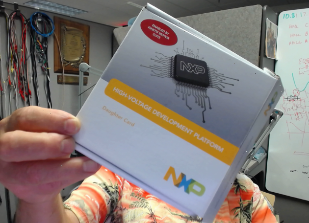

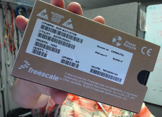

As a general rule: evaluation boards in the thin square white NXP box are KMS enabled boards.  I'm holding up one of these boxes in the picture below.  The older Freescale brown boxes may not be KMS enabled.

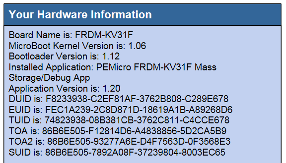

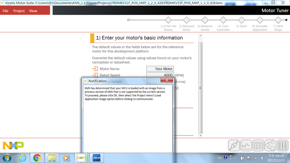

Dear Philip,
FRDM-KV31F,but I'm not sure if the issues is the same as what you describe,please see the below picture and confirm it first, thanks a lot !
Hello Allen,
From the photo and screen shot you supplied it looks like the board is already KMS enabled.  There are two parts to the KMS support; 1) The KMS library stored in flash at the top of memory 0x7E000 to 0x7FFFF (8 K). This library is protected as execute only.  2) The KMS reference project is specific to the KMS release, MCU, control type and eval board.  It is expected that if you choose another control type that KMS would give the message.  From the Notification it shows that the MCU is loaded with a KMS reference project from a earlier release of KMS.  When you press OK does the new firmware get loaded?
KMS uses the FRDM-KV31F OPENSDA firmware from P&E.  Some of the FRDM-KV31F boards had the MBED OPENSDA. If you have that then I will have to re-program the board.
Otherwise to verify you have the correct OPENSDA and the latest version of P&E's OPENSDA, open a file explorer window, and open the virtual mass storage device.
Then open the SDA_INFO.HTM, Allow the opening of the P&E web page to view the version. The latest version is obtained from P&E micro's web site.
You should at least have loaded MSD-DEBUG-FRDM-KV31F_Pemicro_v120.SDA.
