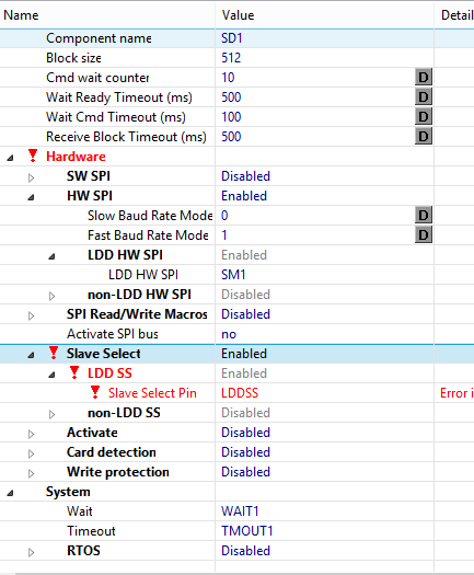

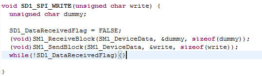

emilioaronmoyer

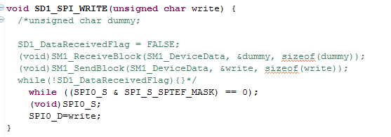

I figure it out how to solve the enable slave select of the SD1 component, i could build the project with no errors, when I tried to run the program,pastedImage_1.png
it get into a while and never goes ot if it. This while is in the SD1_SPI_WRITE() funtion pastedImage_0.png
Then I tried just calling that funtion infinite times (infinite while) in the main.c to see with an oscilloscope if it is sending pulses, but I got the same result. Get into the same while.
Then i tried to with a code I had in the fuction SD1_SPI_WRITE() and do the same infinte while, but now I can see pulses with the oscilloscope. So the spi is well configure.
Do I configure something wrong of the sd componenet?? Why the spi is sending nothing with the code generated by defualt??
I attach my project.

emilioaronmoyer
Hello Hui_Ma,
Yes the problem is not SPI, the SPI works but when I load the other components (sd1:sd_card and fat1:fat_filesystem)
It never goes out the while loop of the SD1_SPI_WRITE() funtion.
Is there another way to do it?? or what am i doing wrong??

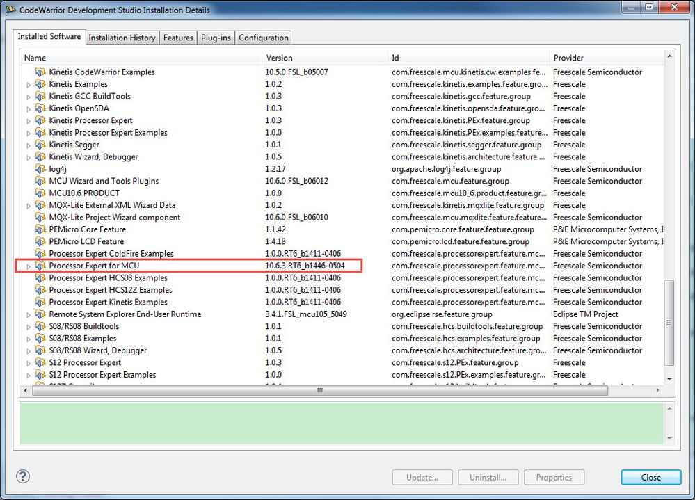

Hui_Ma
I download your attached <fattest.rar> file and there without any compile error reported during project build.
If you attached another project?
You could using CW menu [help]->[About CodeWarrior Develop Studio]->[Installation Details] to check Processor Expert version.
Please check your processor expert tool version, below is my tested processor expert software version:
Customer can use [Help] -> [Check for Updates] to update the Processor Expert software.
Wish it helps.
Ma Hui

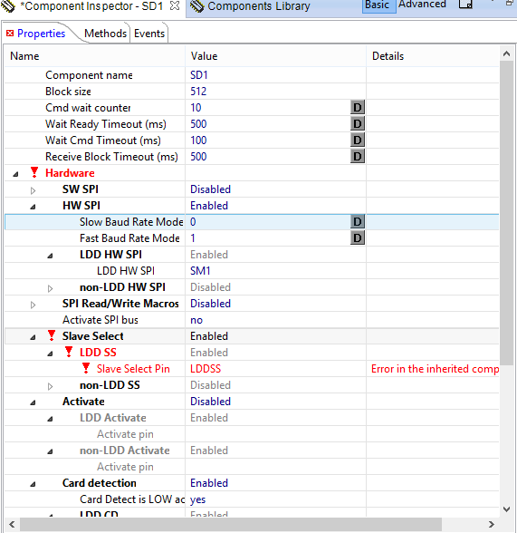

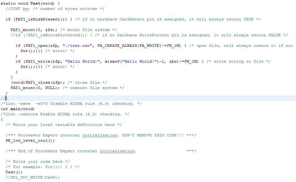

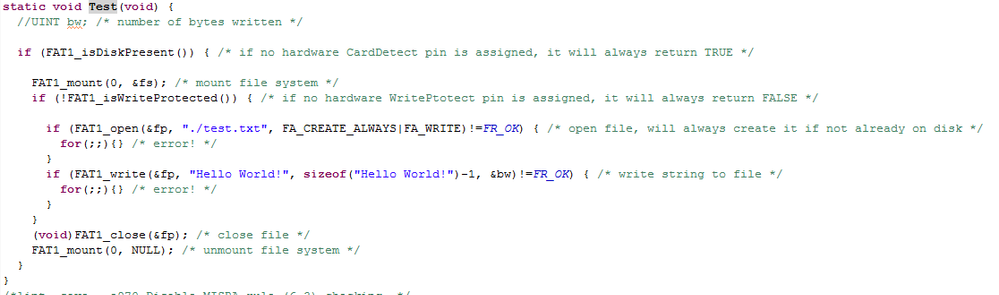

emilioaronmoyer
Hello Ma Hui,
I update the processor expert version to the one you have. But I still have the same problem, in the SD1 component when I enable the Slave Select  I got this error:
If I disable the slave select, no errors appear but nothing happen with the sdcard.
It never enter to the FAT1_open funtion in the main part, it just do the fat1_mount and then finish the program.
I'm using this adafruit module to write to sd card.https://www.adafruit.com/products/254https://www.adafruit.com/products/254
I reattached the slave select enable, so you can see the error.
Emilio
