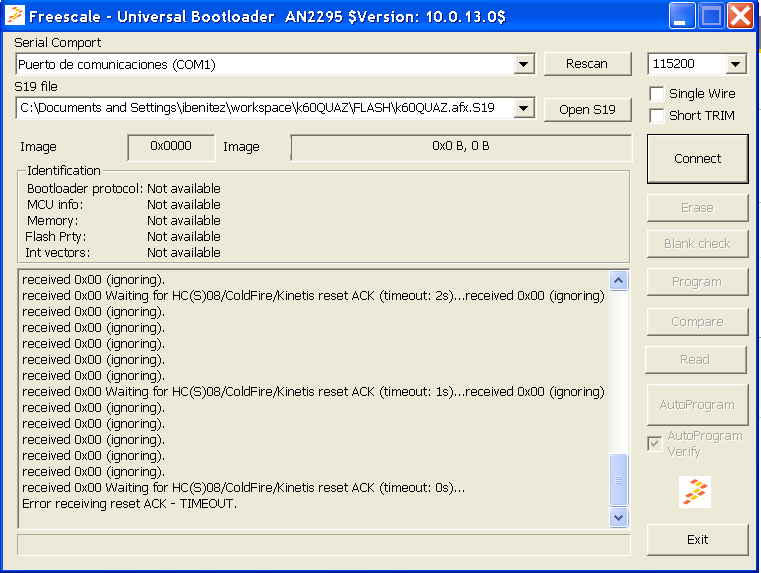

I am trying the bootloader with the appnote 2295. But the win_hc08sprg.exe always make this:
Which may be the problem? Thank you.

As long as your device is not even establishing connection (identification pane has not information) I suggest you to ensure that your device is on that COM port.

I can see clearly enough the pin information. Which are exactly the pins I must connect to the com port when using a MK60DN512VLQ10? Thank you.

You must connect USBx_DP and USBx_DM wich are Data+ and Data- respectively.
In order to achieve correct connection I suggest you to:
1) Connect your device to the PC
2) Open Universal boot loader AN2295 application press connect
3) Perform a Power On reset to your device-->The idea to do it in this way is to force the application to detect and sync your PC with your device communication

it is not supossed to be connected by UART? I thought I was trying a serial communication by a serial port, not by USB.

I apologize, I thougt you was using a microcontroller with USB module, you are right about UART.
You only need to connect Tx and Rx.
If you have this connection follow the steps I mentioned before
