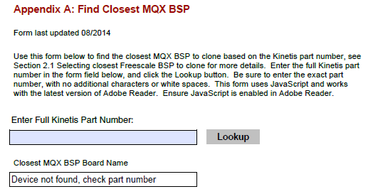

Hello Joseph,
The differences between these two MCUs you find out from datasheets.
You can try it by this way.
Choose the closest BSP to your device (last page at MQX_BSP_Porting_Guide.pdf) and clone it and modify it for your MCU.
You can start with
  • MQX_BSP_Porting_Example_User_Guide.pdf
  • MQX_BSP_Porting_Guide.pdf
located in MQX folder C:\Freescale\Freescale_MQX_4_1\doc\mqx
and MQX_BSP_Cloning_Wizard_Getting_Started.pdf
located at C:\Freescale\Freescale_MQX_4_1\doc\tools
Creating new BSP is very discussed topic at Community, you can find a lot of similar problems like yours.
You can look at similar thread here Re: Creating a New BSP
very useful thread could be Re: Port BSP or go bare metal with PE?
