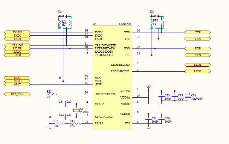

We plan to remove the 50Mhz crystal from our design,will it cause any problems with our core MCU(MK60FN1MOVLQ15)
There is a 12Mhz crystal present already and we plan to run the controller with the following modules enabled.
There will be two PLLs used,96Mhz for USB and 150Mhz for normal operations
We plan to use :
Ethernet
USB (with 96Mhz PLL)
SD card
Two UART modules
PWM modules
DMA modules
Thanks in advance,
Arun

As Mark mentioned, you need a 50MHz clk signal to feed the Ethernet module in RMII however there are available Ethernet PHYs that provide a reliable 50MHz reference clock signal for this purpose. These PHYs of course need a XTAL or resonator to provide them with a reference clock signal.

You can use LAN8720, it can take a 25MHz crystal and output 50MHz for MCU.

I was referring to that type of PHY: KSZ8081RNACA; and as I mentioned it needs an external clock signal provided either by an XTAL or resonator. I am not certain there is any PHY with an internal clock generator that saves you using an external XTAL/resonator

To successfully synchronize the PHY and Ethernet module with the same clock signal so, if you provide the KSZ8041NL with a 50MHz signal make sure that same signal is fed to the K60's Ethernet CLK_IN pin, which is independent from the core and system clock.

Yes sir,we figured that out eventually.Currently we are going to use a clock buffer(NB2304AI1HDR2G) to give the same clock signal to the MCU and the Ethernet PHY..

If you use Ethernet and RMII mode you need to use the 50MHz clock to synchronise the Kinetis to Ethernet PHY otherwise it won't be able to operate reliably.
