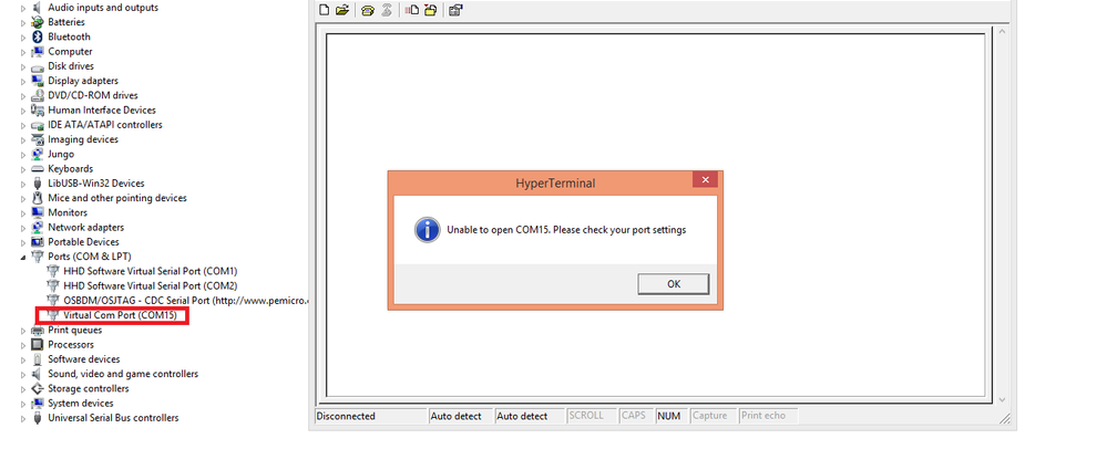

hi,
I am trying to use usb_cdc_msd demo from freescale usb stack 4.1. on k60n512vmd100 tower kit. My PC detects both storage and virtual com port. I'm able to access storage but when I try to open COM port it says "Port is being used by another application". I've windows 8.1 on my PC. I thought it was driver issue but when I ran  cdc_demo from example projects then virtual com port is working properly. Can someone help ??

Hi Prashant,
Please check the jumper settings. I was able to run the cdc_msd and communicate with CDC port with no issue.
I used the Freescale USB Stack v4.1.1 from https://www.nxp.com/webapp/sps/download/license.jsp?colCode=USB_STACK_V4.1.1 , TWR-K60N512 and TWR-SER as development boards and Windows 10 OS.
To see the jumper settings please check https://www.nxp.com/docs/en/user-guide/TWR-K60N512-UM.pdf on chapter 2.11.
Felipe

prashantdev
Thanx Felipe for ur repsonse. I tried above USB stack and made the jumper setting according to the document but problem is the same. Device get enumerated as storage and COM Port. I can access storage but can't open the port. I am attaching the error snapshot.Screenshot (30).png

FelipeGarcia
Hi Prashant,
I tried the example using TeraTerm. Also, could you please try by disabling the device and then enabling. You can do that with right-click the virtual COM port in the device manager.
Hope it helps.
Felipe
