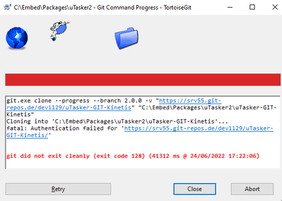

Hi Mark,
You provided me access to the GIT repo with username and password on 1 June. I've previously been able to download the root branch, but in the last few days I don't get past security:
Please can you resend/reset the password?
10,760 Views
mjbcswitzerland
Specialist V
Hi Mark
Free commercial accounts time out after 5 days according to the licensing agreement.
However you don't need access to switch between branches. When you clone the repository you have all branches contained in the local copy and you can switch between branches using the GIT switch/checkout command. I think it will ask you to stash any changes made so it can do this but essentially you can freely switch around between branches and specific commits without losing any work or having to specifically back-up data (the great feature of GIT).
I have also reset your account so that you have another 5 days access in case of any complications.
Mark
