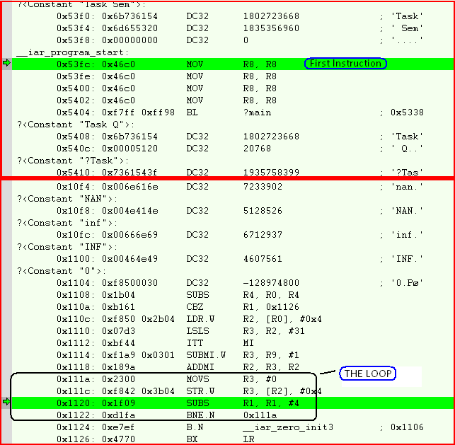

Hello all.
As i'm new here i present myself. I am Corentin, 27yo, and I work as a software engineer near Paris.
For personal project, i am trying to run uCOSIII on TWR-K60N. I am working with IAR 6.50....
uCOSIII software seems not to work. It crashes after the very first asm instructions (starting with __iar_program_start).
It seems loops cause a problem. Indeed, i can set a break point just before the loop which initialise the bss and go to this point by running the soft in debug mode. If i try to set the break point after the loop and run the program, it automaticaly return to the first asm instruction (__iar_program_start)
I debug the system with OSBDM JTAG.
I didn't manage to see what causes the reset.I got the sources from the micrium website, especially ported for the TWRK60N512.
While debugging, i manipulated internal register to exit the loop but same problem appears after, at the next encountered loop.
I tried to download a "hello world" project to ensure hardware is ok, and it works perfectly.
Thank you very much for taking time. Tell me if you need more details.
Corentin

The ASM as indicated:
2,247 Views
Hui_Ma
Kinetis K60 watchdog module is enabled after chip reset, it need to refresh it or disable watchdog module in software.
Please refer below code to disable watchdog module:
* Watchdog timer disable routine
* Parameters:
* none
void wdog_disable(void)
    /* First unlock the watchdog so that we can write to registers */
    wdog_unlock();
    /* Clear the WDOGEN bit to disable the watchdog */
    WDOG_STCTRLH &= ~WDOG_STCTRLH_WDOGEN_MASK;
* Watchdog timer unlock routine. Writing 0xC520 followed by 0xD928
* will unlock the write once registers in the WDOG so they are writable
* within the WCT period.
* Parameters:
* none
void wdog_unlock(void)
  /* NOTE: DO NOT SINGLE STEP THROUGH THIS FUNCTION!!! */
  /* There are timing requirements for the execution of the unlock. If
   * you single step through the code you will cause the CPU to reset.
    /* This sequence must execute within 20 clock cycles, so disable
         * interrupts will keep the code atomic and ensure the timing.
        DisableInterrupts;
    /* Write 0xC520 to the unlock register */
    WDOG_UNLOCK = 0xC520;
    /* Followed by 0xD928 to complete the unlock */
    WDOG_UNLOCK = 0xD928;
    /* Re-enable interrupts now that we are done */
           EnableInterrupts;
Wish it helps.
Ma Hui
2,247 Views
corentinnicolas
Hello, thank you very much for your answer.
Your response seems to be correct. Meanwhile I've downloaded FreeRTOS, which includes appropriate boot files. Indeed, with uCOS III boot file are not inculded, so it seems IAR uses default files, which don't work for my application. Have a good day, thank you.
Corentin
2,246 Views
Hui_Ma
Hi Corentin,
I check default IAR startup code (__iar_program_start) without disable Kinetis watchdog. You can check attached code for more detailed info about IAR default startup code (the code located at ..\IAR Systems\Embedded Workbench 6.6\arm\src\lib\arm folder).
Wish it helps.
Ma Hui
