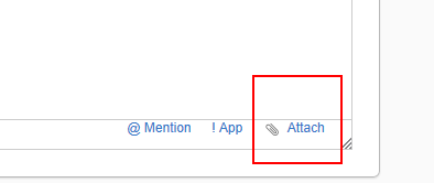

Hi  Space,
When you want upload attchment,  please click here :
then
Alice
