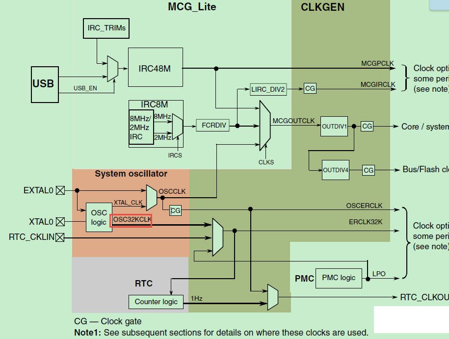

We're trying to set up the SLCD controller bit by bit on the KL43 (we're using the FRDM board). We've turned on the SLCD clock and we've set up the SLCD registers properly (I think). The clock is left at the default to use the internal oscillator and then we turn on the PAD_SAFE, and then set the control to an internal 1 V reference on Vll1 w/ charge pump etc. We enable some pins and write some waveform registers.
Just to see if it works, we probe Vll1,2, and 3 and, besides not seeing any lcd waveforms, see that vll2 discharges like a capacitor upon contact with our scope probe.
We have not touched the PCR registers because the default setting seems to be correct.
Are we missing something?

So after several hours I solved my own problem. Thanks for the help Mark, but because your comment got hidden during moderation, I wasn't able to use your resources.
Basically I didn't realize I had to set registers in the OSC and the MCG areas to get the 32k to turn on. Even after giving the docs a thorough read, I still find the clock structure somewhat obtuse.

Hi Andrew Pikul,
    Thank you very much for the resolution sharing.
    If you use the default the clock for the SLCD source, you really need to enable OSC, because the default is using the OSC32KCLK, you can find it in the KL43 reference manual.
Wish it helps you!
If your don't have any other problem, please help to mark the correct answer to close this question.
