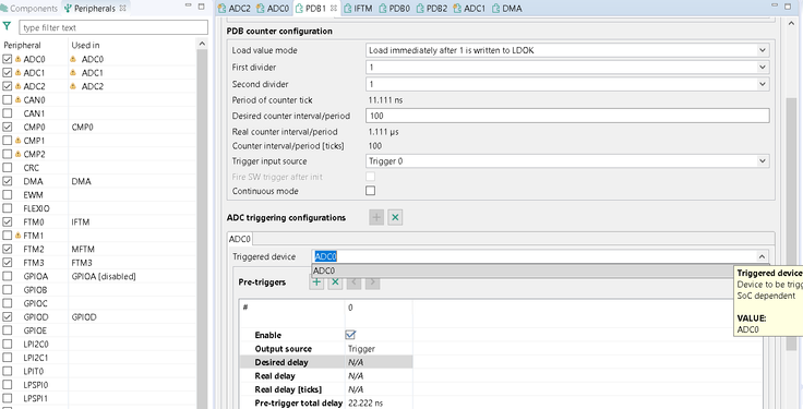

Hello there
when I try to set my PDB1 on MKE1 MCU at MCUXpresso .I can not set the triggered device to ADC1 !!
the only option to connect the PDB1 trigger output is to ADC0 !!?
how can I link PDB1 trigger signals to ADC1 ?

You can modify the code directly to trigger adc1 via pdb1.The main areas need to be modified has been marked in red.
I will update if here has some issue.
