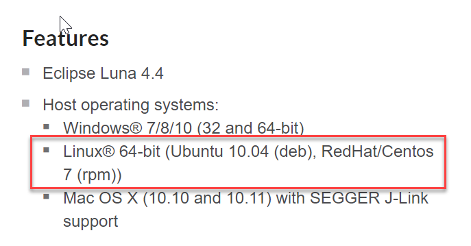

Hui_Ma
I checked KDS supported PC OS doesn't included Linux Opensuse Tumbleweed 64 bit:
Thank you for the attention.
Mike
