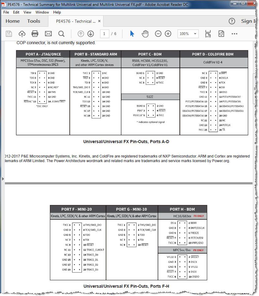

Robin_Shen
Which PORT of USB Multilink Universal are used to connectted K64?
Please also show us the debug port circuit of K64.
Robin

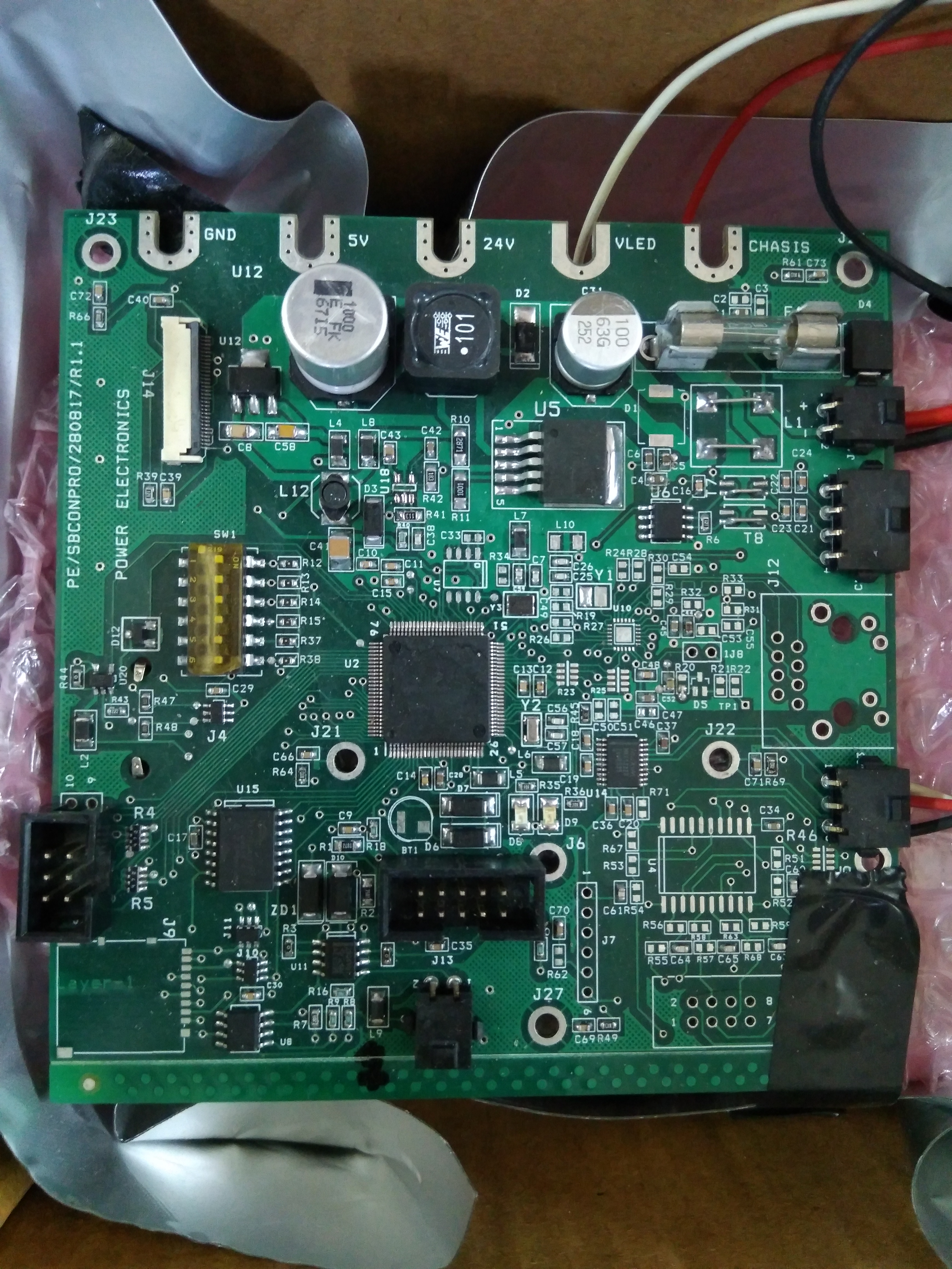

aratisood
Hi Robin,
Sending you a photo of our custom Board,
But the problem is with the USB Multilink not the board .. because the USB led on the USB Multilink is not glowing anymore so it seems to be a power supply or some other h/w issue
Meanwhile I have written to PE Micro tech support also ..according to then it is some h/w issue on the USB ML..Hopefully they will also help us..
