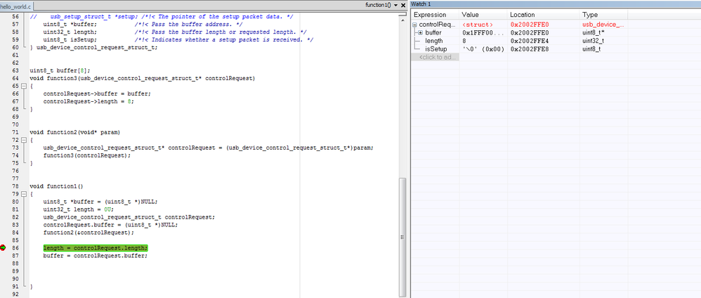

I wrote this code to demonstrate something I found in the KSDK USB library. I took (interpreted?) this code from usb_device_ch9.c starting around line 862.

The expectation is function2 will give controlRequest.buffer something to point to but controlRequest.buffer is still null when in the context of function1() just after calling function2(). I would never do it this way but this is the framework of the KSDK USB driver. I'm probably forgetting to explain something here but hopefully I can at least get a conversation going?

Isn't function3 wrong, among other issues?
void function3(usb_device_control_request_struct_t* controlRequest)
    controlRequest.buffer = buffer;
    controlRequest.length = 8;
should be:
   controlRequest->buffer = buffer;

Yes, controlRequest is a pointer in function3, should be  controlRequest->buffer = buffer;  or else there will be a compile error.

Hi Ryan Lush
I am not sure I fully understand you, I copied your code to hello world project, and found the controlRequest.buffer point to 0x2002FFE0.  Please see below picture.
