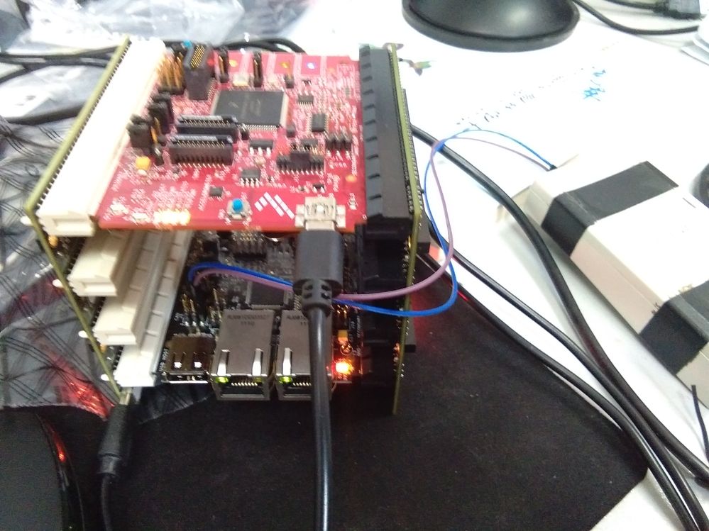

minminzhengzhen
hello:
I have connected the CAN transceiver functions of the TWR-SER2 correctly, I connect the Can_high and Can_low to the CAN card which is made by my team. For the clocking the CAN subsystem,The CAN engine clock source is the peripheral clock.The program is:
#define CAN_CTRL1_CLKSRC_MASK 0x2000u
CAN_CTRL1_REG(CANBaseAdd) |= CAN_CTRL1_CLKSRC_MASK;
and I can finish the loopback test successfully, so I think the clocking ought to be correct. When I don't use "loopback", I can't see waveforms by Oscilloscope,and the Can_high and Can_low are no Electricity level change.
I don't know why, and I have thought for several weeks.please help me.

egoodii
Senior Contributor III
You keep not answering anything about the termination resistors.
But loopback-mode can clock its own bits at ANY rate or jitter, however real transfers require an exact match between bus members.  We should want to know the original source (and freq) of the selected peripheral clock.

egoodii
TWR-SER does NOT build-in termination, and MOST CAN nodes do not, as you ideally only want 120 all the way 'at the ends' of a bus.  What does an ohm-meter measure between the lines (powered off, of course!)?
Can your 'other node' send a message (getting an ACK from Kinetis!)?
OK, so in TWR-SER2 the 120.8 ohms supplied by R502+R509 will be the termination for ONE end of the wire-pair.  What resistance can you measure across your connected pair?   By the way, it is also necessary for all the nodes of a CAN bus to share a 'generally common' ground reference (within a few volts of each other) as a DC-connected bus.  While you have your ohm-meter out, check for a direct tie between the appropriate CAN_TX in of the K60(also accessible at one end of R130) to the TX pin of the transceiver chip.  I assume all jumpers of J4 are installed on TWR-SER2.  Have you pulled R91 and R130 from the TWR-K60F120 board to isolate PTC16&17, AND is this the module(CAN1)/pin-selection you are making when you call the init routine?
So, if your CAN_H and CAN_L wires just 'sit' constantly at about 2V when you think you should be sending a message, we need to look further upstream for a disconnect.  Now, starting at the processor, do you see TX activity (after a 'send message' action) on the appropriate CAN_TX pin of the processor?

minminzhengzhen
hello:
the hardware have the terminating resistance including the R502+R509.I think the hardware has no problem. when the can transmits,the Oscilloscope can Collect the square signal according to the pin of CAN_TX .
And I also connect the port 3 and 4(CAN_TX and CAN_TX1) of CAN_ISO according to the Jumper.
But the CAN_H and CAN_L have no signal. Do you know why?

egoodii
ONE set of 120-ohm termination is NOT enough to 'properly' load the CAN pair, there needs to be a SECOND 120, to net 60ohms.  However, even just that should show SOMETHING on the pair, just not 'clean' enough.  Do you measure 5V+/-0.5V on U501 pin 3?  For CAN you must also tie-across CAN_RX and CAN_RX_I, as full CAN message transmit REQUIRES that the sender see their OWN bits, AND 'ack/nak' responses from ALL other bus slaves.  Are you tying across CAN_S and CAN_S_IN?  CAN_S_IN must be 'low' to enable TX functions in the TJA1051T/3, so I would NOT tie them, just let R503 pull it down.
So you are saying you DO see a continuous stream waveform on CAN_TX?

minminzhengzhen
this is the waveform.
I measure the voltage on U501 pin 3,but the voltage is about 3V rather than 5V+/-0.5V.
86,242 Views
egoodii
Your scope-shot gives me no indication of 'time scale', but it looks like it might be a reasonable TX-response/retry for 'no feedback on RX', which we will not get until we see something on the bus lines.  And for that, 3V on U501 is DEFINITELY a problem, as if you read the TJA1051 datasheet you will see it has an 'undervoltage lockout' that triggers 'somewhere just less than 4.5V' which will PREVENT any transmissions!  You need to track down how TWR-SER2 is supposed to get 5V, and you may need to supply some external DC to elevator regulators to get that --- 'nearly 5V' from USB will probably NOT be a reliable source to guarantee >4.5V at U501.
And PLEASE confirm you now have a net 60 ohms of resistance across the wire pair, AND some 'common ground' between your K60-tower and the other CAN box.

86,242 Views
minminzhengzhen
I don't get method about how TWR-SER2 is supposed to get 5V. I am trying to do.I did not reply to you so as not to disturb you yesterday.
86,242 Views
egoodii
https://cache.nxp.com/docs/en/application-note/AN4649.pdf?fsrch=1&sr=2&pageNum=1
Figure 5 makes it look like you need J7, and supply 5.2V on J10 with SW1 set to 'external'.
