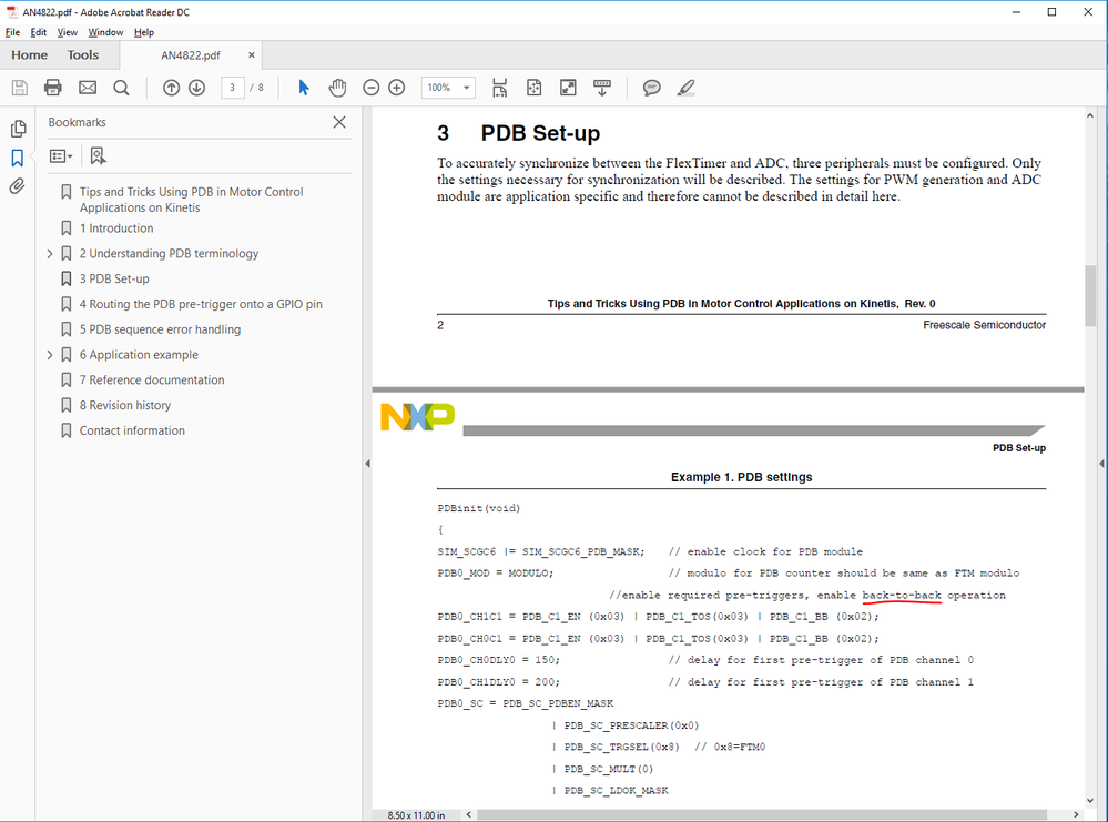

any code as example/app note for using pdb for back to back conversion in k22f family?\

Please refer the Application Note AN4822 "Tips and Tricks Using PDB in Motor Control Applications on Kinetis".
