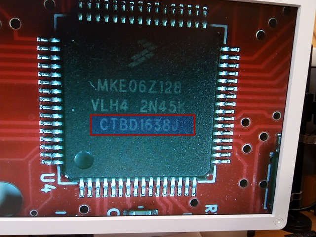

What does this number mean?
thanks in advance,
gaston

The red block code is trace code.
CT: assembly site;
BD: wafer LOT;
16: Year 2016
38: Week No.38 week of 2016
J: assembly LOT suffix
Wish it helps.

Great! Mike, thank you for the detailed information.
regards,
gaston
