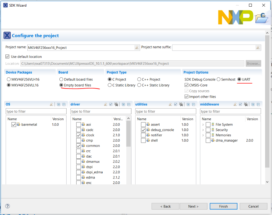

I am new to MCUXpresso IDE. All the demo video and documents ref. to demo boards. Where can I see detailed explanation how to create a project on bare board? I am using my own design board with KV46.
I tried creating KV46 zip with the SDK, and importing it to the IDE, but I am got strange error messages without writing a single code line!
Please help...
TIA
1,638 Views
Robin_Shen
Please refer:
Then you may need to configure the clock and Peripherals according your own board.
Robin

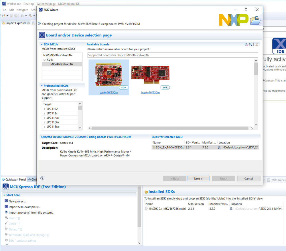

Hello Robin,
Thank you for your answer. I did it all, but it did not help. I found the reason after 2 frustrating weeks, and Jennie confirmed it in her answer https://community.nxp.com/thread/473673  . MCUXpresso can't work without Internet connectivity. I tried to work off-line, after installing MKV46 SDK.
It's a pity that the program does not popup a message that Internet connectivity needed, instead I saw that no MCU selected - without understanding the reason. It could save me a lot of time.
Please put a note to all this product users here ....
