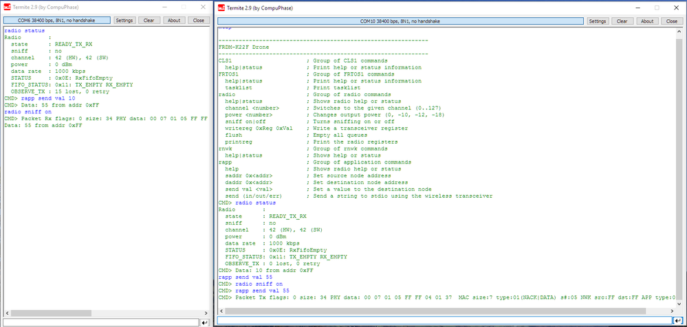

Hi Marco,
attached is a zip file with all the sources (project is on C:\Users\Erich Styger\Data\GitRepos\McuOnEclipse\Examples\KDS\FRDM-K22F). It uses the USB CDC (documenation folder contains the cdc.inf in case you don't have it) on the board. Below is an example session of two boards sending messages to each other:

paulomontanher
hello Erich
I'm adapting their code to the FRDM K22, I have all the radio response signals however can not carry out the transmission and reception of data, and the radio does not generate the interruption of IQR.
I am using 2 FRDM K22 with radio connected at J6 SPI communicating and getting response, however do not use the P & E, only use the drives of KDS 1.3
Do you have any idea what can contecendo'll be here.

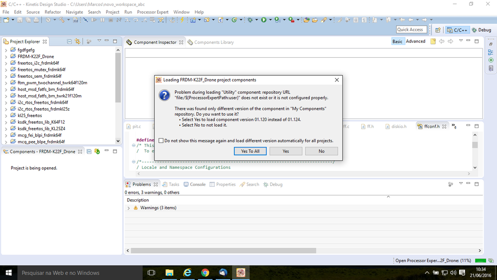

We find a problem as we open your project in KDS v. 3.2. It looks like you have made this project in a previous Processor Expert version, right?
How can we fix this problem? If we ignore this error and go on, we find a lot of conflicts and can't correctly compile the project.
Another point is that Paulo has made all his project based on KSDK v. 1.3, without Processor Expert, and only nRF24L01 part is left to finish it. Is it possible and feasible to copy only the code related to nRF24L01 generated by Processor Expert from your project and add it to Paulo's? We have no idea of how much this could conflict with KSDK in his project...

Hi Marco,
Have you (they?) loaded the latest versions of components from SourceForge already (McuOnEclipse - Browse /PEx Components at SourceForge.net )?
That dialog basically tells that the project loaded uses newer components than present on your system.
About the second point: I have not done that, but I think that will not be simple and easy. Because it means that the low level SPI driver/interface needs to be switched to the SDK one. Doable, but for sure will take some work.

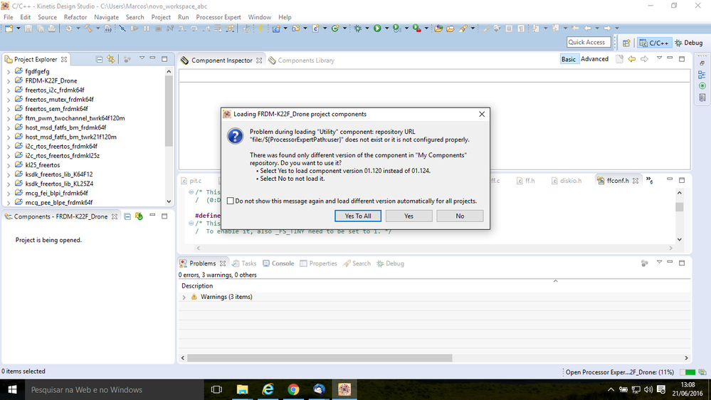

MAPC
Senior Contributor I
Hi again Erich!
I just clicked on "Yes to All" (accepting to load in PE v. 01.120 instead of v. 01.124) on that message, generated Processor Expert code and recompiled the code. Despite some builder warnings, it looks like it is working fine now:

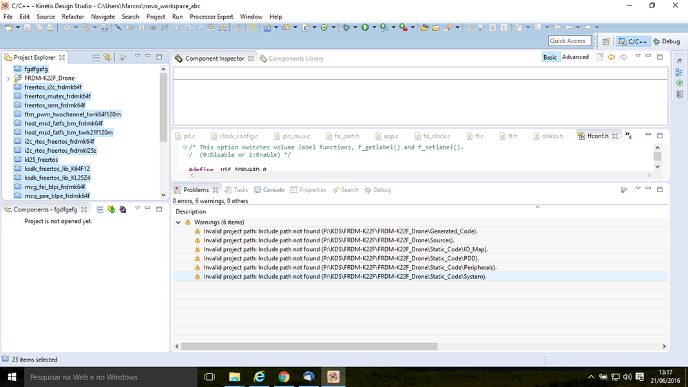

MAPC
Hello, Erich
The latest MCU On Eclipse PE components I have found and downloaded in SourceForge were:
But I keep getting the same message from KDS 3.2:
Marco Coelho
6,126 Views
BlackNight
Hi Marco,
ah, yes, my bad. I have a version 1.224 of the utility which is not released yet, so my fault :-(

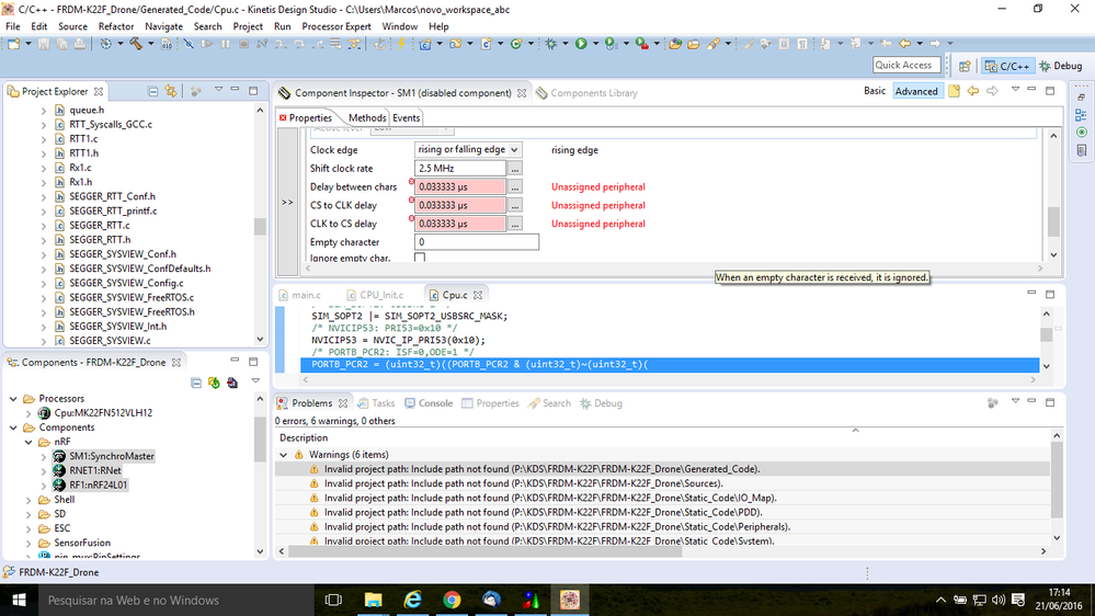

MAPC
Hello Erich,
I'm taking a look at your project and noticed that the components SM1, RNET and RF1, related to the tranceiver nRF24L01 are disabled and their code was not created:
Could you please export those PE components settings and send them to us please?
