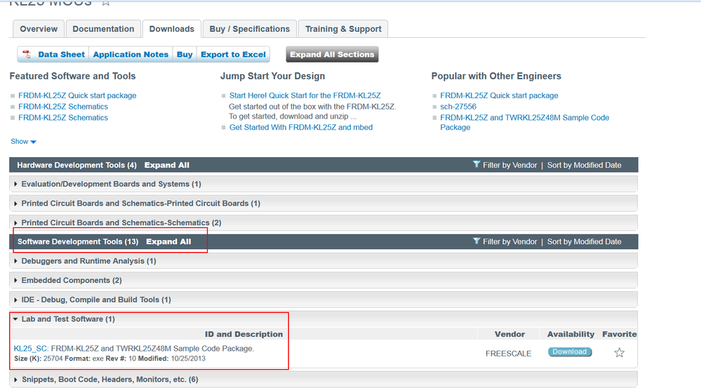

Hello Shabana,
Which chip of kinetis L series ?
For some demo code of chips or boards we can find on freescale web , for example , the KL25 chip,
in the view of KL25 on freescale web , we can see
the ""KL25_SC" is the demo code , the website is Freescale Freedom Development Platform for Ki|Freescale .
You can refer to this way find the demo you want or tell us the name of your chips.
