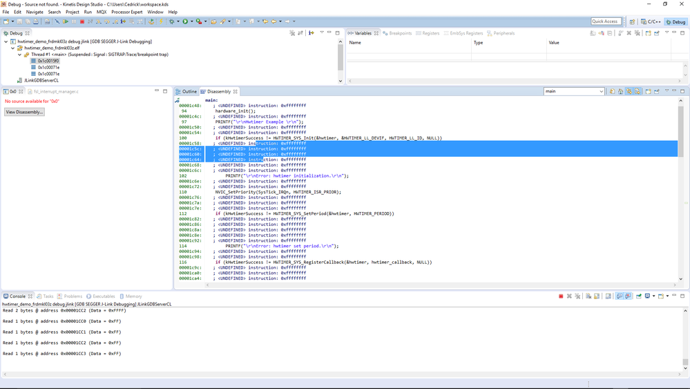

Yes jlink commonader can see the processor
when i think there is a problem with the binary that is created. when i look at the dis assembly, some sections seem to be left undefined(even for the demo apps).
my isr shows much of the same.

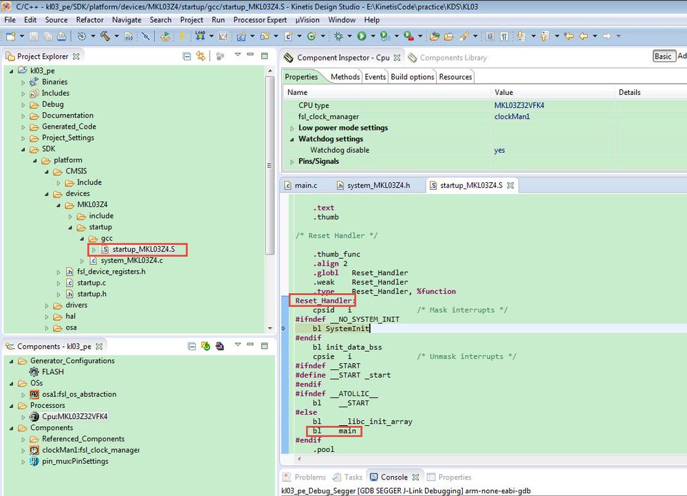

    I use the KDS create a Processor expert with KSDK1.3.0 for your referece.
    You can find the main calling in the startup_MKKL03Z.s, in the startup file, there has a reset handler which calls the main function, just like the following picture:
  The project is in the attachment.

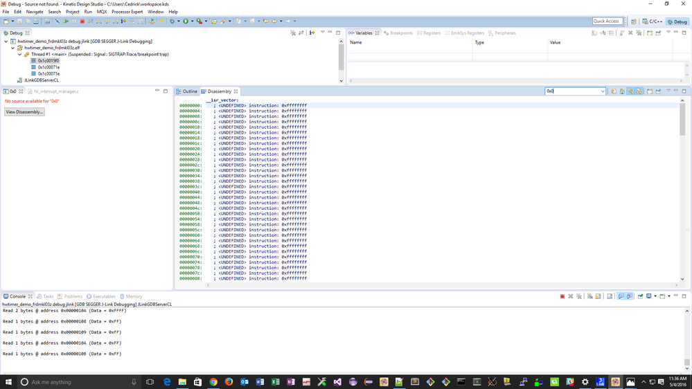

I do have all the of the start up files and my .S file does have the reset handler. The problem is when i run my application and try to debug it I seem to have nothing in 0x00000000 and 0x00000004. These should be the initial stack register value and pc. Because they are missing my fails to initialize properly. Yes I am using kds with pe. I am all so using jlink on my custom board to read see what is going on.
any suggestions would be welcome. I think i am making a mistake somewhere in my linker settings. I am pretty sure processor expert generates they initial isr.

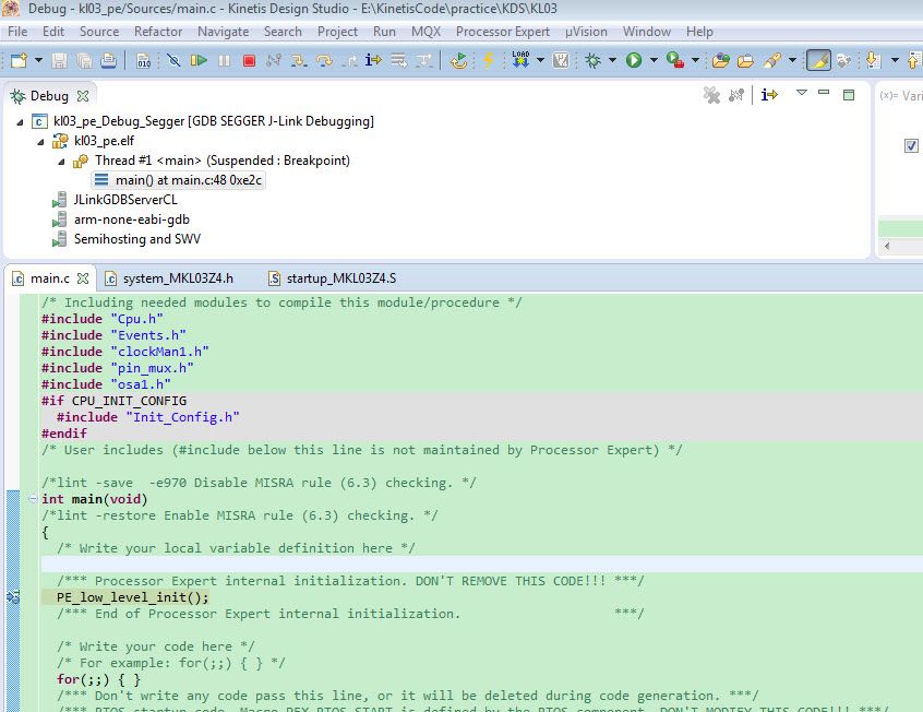

I tried you example and i never hit my breakpoint in main. The device starts up and the vector table but when i click run it just goes into the weeds.
Thank you

I would like for the reset handler to call main when it is done. But there is nothing but ffff in the 0x0 and 0x4. How is this configured with processor expert?
