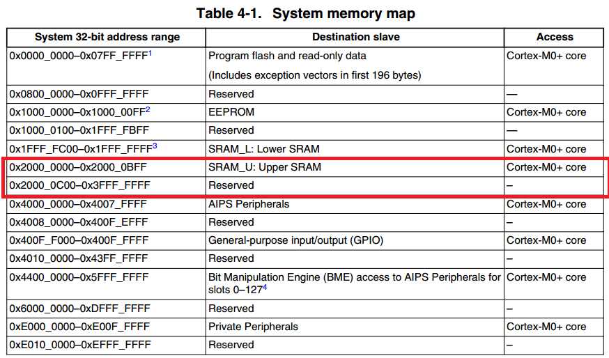

Dear  Expert:
is there a bit-band region of SRAM in KE02(not AIPS)? below is from the KE02 reference manual:

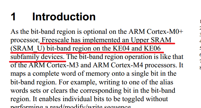

todtodf
Dear  Expert:
thanks for your support.
But you can download the AN4838.pdf from www.nxp.com
The is a description below:

mjbcswitzerland
Specialist V
KE04 and KE06 are indeed exceptions in that there is really a bit-banding capability in the upper SRAM (I didn't think that any Kinetis Cortex-m0+ parts had it), however it is IS NOT implemented in the KE02.
Mark

mjbcswitzerland
Specialist V
The KE series does not implement bit-banding (the description is probably a generic one that is used in all documents).
However it does include a bit-manipulation engine which does more or less the same thing as bit-banding (even with more flexibility, although using different address calculations). Unfortunately it can only access peripherals on the KE parts and not SRAM....
