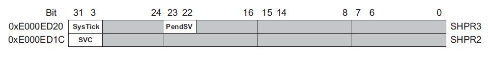

hi,
I don't know the meaning of SCB_SHPR2 register.

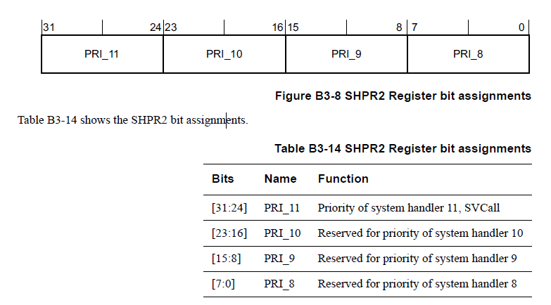

I search out SHPR2 in ARM manual-
but still not clear. for example what meaning if set SCB_SHPR2=0x80?  what difference if i set it as SCB_SHPR2
=0x40?

Hi Hotas,
The group of SCB_SHPRn registers is used to set the pripority level registers for system exceptions. On the Cortex-M0 processor, only the three OS-related system exceptions have programmable priority levels. Three inculde SVC, PendSV, and SysTick (Fig 1).
About your question, 0x40 and 0x80 is same, as apart from the [32-24] bits area are unimplemented in the SCB_SHPR2 register.
                                                                              Fig 1
