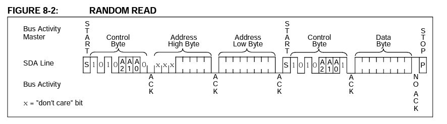

I'm trying to use EEPROM(24FC64) by using LPI2C_MasterTransferNonBlocking function.
I can write data to EEPROM, but I cannot to access Random Read(pls see attached).
How do you do a dummy write and subsequent read using LPI2C_MasterTransferNonBlocking?
Thank you.

Regarding your question, personally I would suggest you to use LPI2C_MasterTransferBlocking, because non-blocking function is going to read/write just one byte every time that it is being called and not the full message that you want to read/write on your EEPROM. It happened to me twice.
Also, can you please explain me what is your intention for doing a dummy write?

Dummy write means that it is write command without write bytes.
I feel it could be done by setting up the following.
lpi2c_master_transfer_t masterXfer;
memset(&masterXfer, 0, sizeof(masterXfer));
uint8_t dummyBuf[1] = {0};
masterXfer.data = dummyBuf;
masterXfer.dataSize = 0;
So,I send dummy write command and read command,  I could random read access with EEPROM using LPI2C_MasterTransferNonBlocking.
