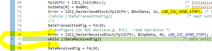

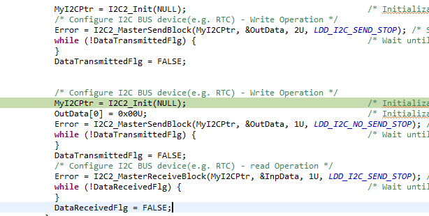

Using PE example, got communication between FRDM board and 24LC00 but can't seem to write a read accurately.
First I do a block write then block read using typical example for I2C component.
volatile bool DataReceivedFlg = FALSE;
volatile bool DataTransmittedFlg = FALSE;
uint8_t OutData[4] = {0x00U, 0x01U, 0x02U, 0x03U};                /* Initialization of output data buffer */
uint8_t InpData[16];
LDD_TError Error;
LDD_TDeviceData *MyI2CPtr;
First picture is writing of data to device, only two values the first being address zero, second data value of 1.
Second picture is writing of control word and address zero to device in prep of reading
Third picture is the read

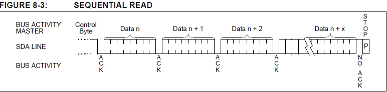

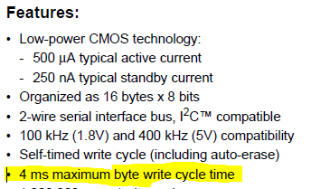

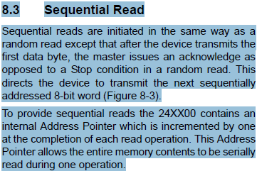

I think I have discovered the true problem.  The 24LC00 doesn't support sequential or page write.  It does support sequential read.  The app note I have been studying made it seem that all24LCxx devices supported some sort of page write.
This is for the 24LC00
this is the 24LC01

I think you are correct. That would explain why 0x5a ends up at address 0! You can only write one byte at a time...

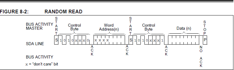

I do see this error.
When you write the address for reading, you should send stop. You should not pass in LDD_I2C_NO_SEND_STOP. you should send LDD_I2C_SEND_STOP instead.
The write has nothing to do with the read. The write is just setting a register in the chip. When you do the read, it will send the address before reading,
11,588 Views
steve_fae
Senior Contributor I
If I change it to SEND STOP, the interrupt never sets DataTransmittedFlg TRUE.  It just hangs there.
Wow, the Microchip data sheet doesn't state clearly that after the write you need to send a stop.
11,588 Views
JimDon
Senior Contributor III
You are correct that it is not clear, because it also says:
If a Stop bit is transmitted to the device at any
point in the Write command sequence before the entire
sequence is complete, then the command will abort
and no data will be written.
Which I took to mean that you should write the address and then send stop, leaving the address register set, but perhaps this is contradicted by what the read command says. Figure 8-2 strongly suggests that you should not send the stop, although I don't understand why the tx would not complete. So I don't think what I said is correct, and that you should change it back.
You should at this point look at error conditions to see if the write is completing error free, and make certain that you do get an ack. I'll keep looking around.
