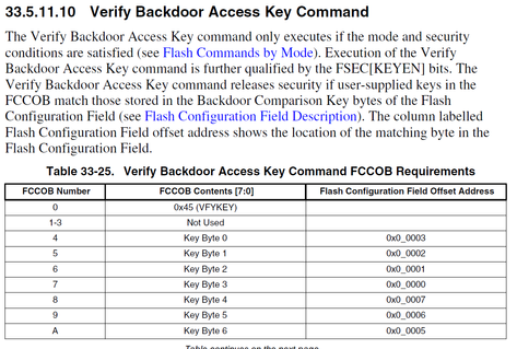

Hi, I want the following to be done once I have flashed the program into the micro-controller. I am using TWR-KV46F150M evaluation board. These are the requirements that I am looking for when I say lock and unlock.
1. When the lock is enabled, the micro should not be able to erase the old code and flash new one when tried.
2. When lock is enabled, the micro doesn't let another person to read the information that is flashed before it was locked.
3. After the unlock is done, micro is as good as new and would allow the read/erase the previous flashed code.
do I have to change the clock settings for this? How will I be able to achieve it? Regards
7,071 Views
jingpan
Section 32.4.1 in reference manual has the detail.
To unlock, Verify Backdoor Access Key command should be send. Section 32.5.10.10 has the detail. If the chip is locked, only firmware can do it.
Jing

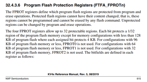

1. Yes, please use FRFA_FPROT register (Program Flash Protection Registers), the detail is in section 33.4.3.6 in RM.
2. If you mean you want to disable SWD/JTAG port, Please use FSEC[SEC] bits. During the reset sequence, the register is loaded with the contents of the flash security byte in the Flash Configuration Field(0x40C) located in program flash memory.
3. FSEC[KEYEN] controls backdoor. By input correct backdoor key, flash can be unlocked.

1. I am referring to the following TRM and the section which you mentioned 33.4.3.6 doesn't exist in this. For this particular micro controller, how should I go on about the locking?

1. Sorry my version is a bit old. please refer to 32.4.3.6.
2. you can send a message to application, let application send Verify Backdoor access Key Command.

jingpan
