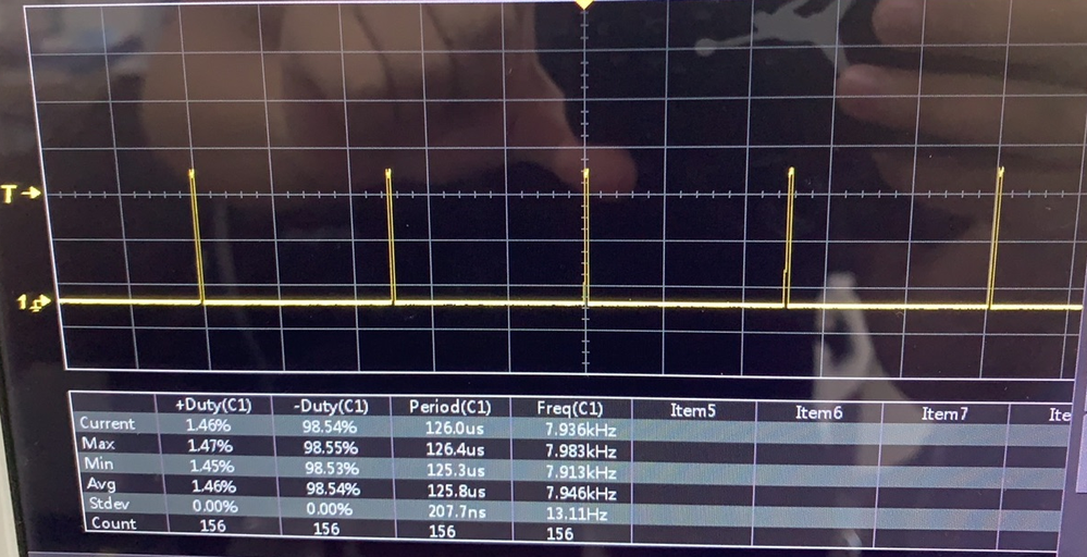

I downloaded the wrong code in it and with the oscilloscope I see the reset pin is being pulled down all the time:
I can't erase it with jlink either, the connection fails. What should I do?

FelipeGarcia
Could you please share the message that shows J-Link when the connection fails?
Felipe
