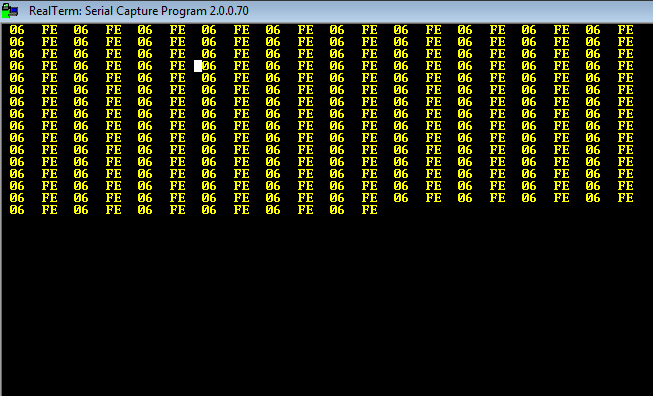

I am working on a custom board with k10mcu mk10dx256. IM trying to implement uart program with it.I have attached the program.I am getting a garbage value on my serial terminal.
heres my program:
#include <__cross_studio_io.h>
#include "MK10DZ10.h"
main(){
char data = 'a';
int i;
unsigned long int SBR_value=0;
char data1,ch;
//pin selection
SIM_SCGC5 |= SIM_SCGC5_PORTD_MASK;
PORTD_PCR3 |= PORT_PCR_MUX(3);
PORTD_PCR2 |= PORT_PCR_MUX(3);
//uart selection
SIM_SCGC4 |= SIM_SCGC4_UART2_MASK;
UART2_C2 |= (1<<3)|(1<<2);
SBR_value = (int) ( (72*1000000)/ ( 16 * 9600) ) ;
UART2_BDH |= ( ( SBR_value >> 8 ) & 0x1F );
UART2_BDL = ( SBR_value & 0xFF );
while(1)
while( !(( UART2_S1 >> 7) & 0x01));
ch|= data;
UART2_D |=ch;
debug_printf("sending\n %s \n %d \n ",data,i#);}
i m getting interrupts but my data is not able to captured in receive program.

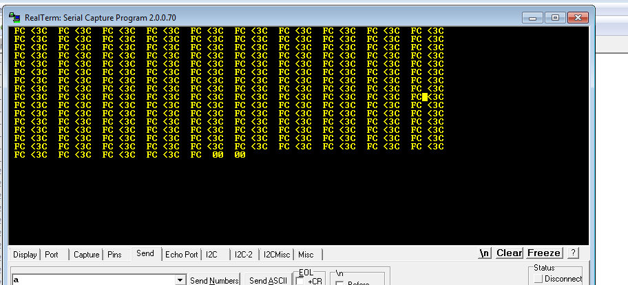

this is my clock configuration
for 72mhz.
this is my output after  configuring the clock.

gnsh2196
hi,
thanks  for your help i have figured it out. there seems to be change in the baud rate calculation.
current baudrate  was set as 19200.
thank you
3,039 Views
jingpan
Hi ganesh,
I think this may the baudrate problem. First, please clarify what kind of K10 are you using. You use K10DZ10.h. This is form 100Mhz main clock device. But in your code, you use 72M to calculate SBR. Second, after reset, the chip clock is in FEI mode. FLL output 20.97M clock to system. You should initialize the clock first.
