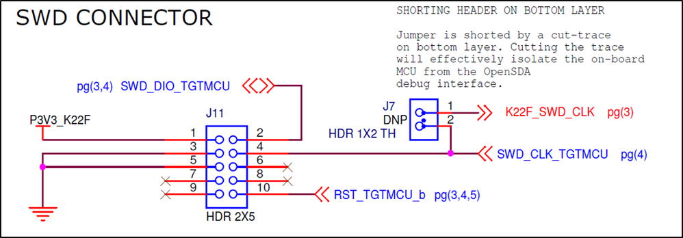

SWO pin not connected.
i think if this pin is connected, it may be operate.
j-link connector
FRDM-K22F connector

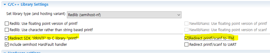

i try build project on MCUXpresso IDE.
as you mentioned, check redirect option and create new project.
(but, there is no "SWO" related options)
and printf still not work.

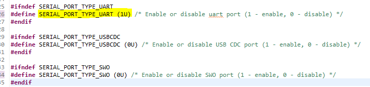

i think the macro defined in "serial_manager.h" is wrong.
"SERIAL_PORT_TYPE_SWO" should be "1".
but if i change this value to "1" (and "SERIAL_PORT_TYPE_UART" are "0" ), build error occurs.
fatal error: serial_port_swo.h: No such file or directory
i can't find "serial_port_swo.h" anywhere.
it seems to be generated by MCUXpresso IDE.
Is there a better way?

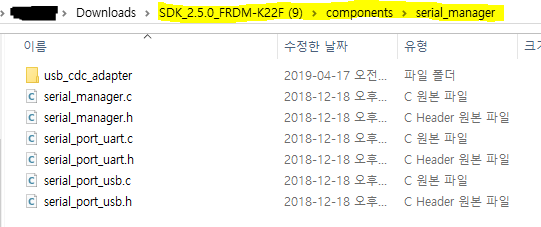

** additionally, Kinetis SDK has no "serial_port_swo.h" file.
The figure below shows the sdk directory. There is no "serial_port_swo.h".
