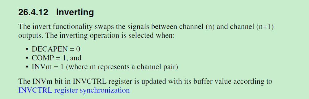

    I have another question.Ch0 and Ch1 can output inverted PWM.Which register can be changed to the same direction?(use combined)
3,595 Views
Hui_Ma
Sorry for the later reply.
Please check below conditions for the combined PWM signals inverting:
The inverting control at FTM Inverting Control (FTMx_INVCTRL) registers.
Wish it helps.
best regards,
Mike
