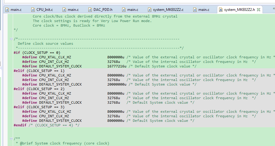

  But in system_MKE02Z2.h, the default code is not like you, this is my code:
But, in this code,

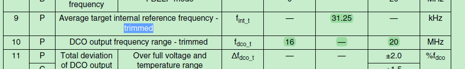

The CPU_INT_CLK_HZ is not correct.
From the datahseet, we can find the internal trimmed IRC is 31.25, NOT 32.768KHZ.
Default_system_clock should be:31.25k*1024 /2=32000k/2=16Mhz.
Please take care of these two points.

  Anyway, you need to refer to the according datasheet, the KE02 trimmed factory value is 31.25Khz, KE04 is 37.5Khz.
   KE02 FLL factor is 1024, KE04 FLL factor is 1280.
