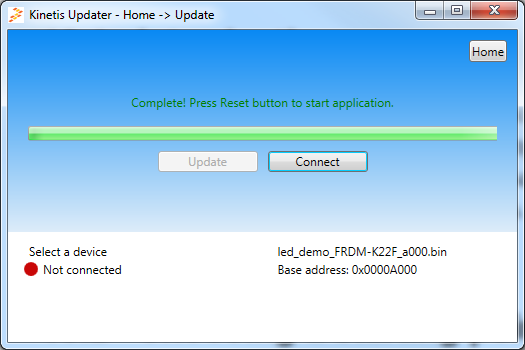

Also, trying to program the target using Windows KinetisUpdater, makes the target reboot.

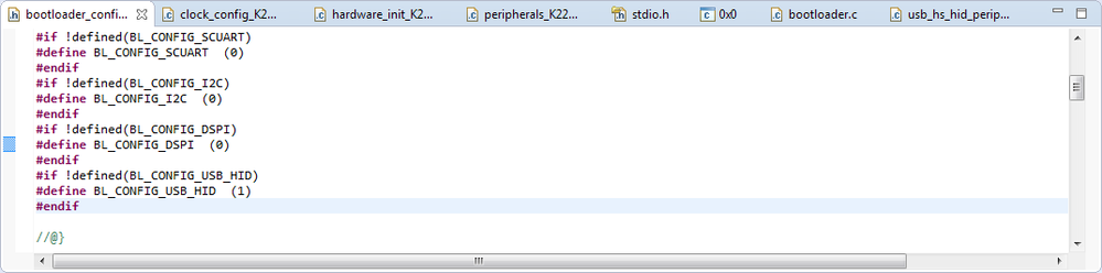

Thanks for the information! From what you mentioned above, I guess you just used USB HID as the downloading interface, right? You know, this bootloader supports UART, I2C as well, and since you use UART1 and I2C0 for other purpose, you may disable them in the bootloader_config.h. like below:
That would help you avoid any possible conflicts, and I have tried to open the KDS project in a new work space, it works as expected. so I think the cause might be the software modification you added for UART1 and I2C0 support, if there is no more changes.  Please only enable USB HID and see if it makes any difference.

- Windows flash loader does not its job correctly (application is not running after flashing)
Nicolas
