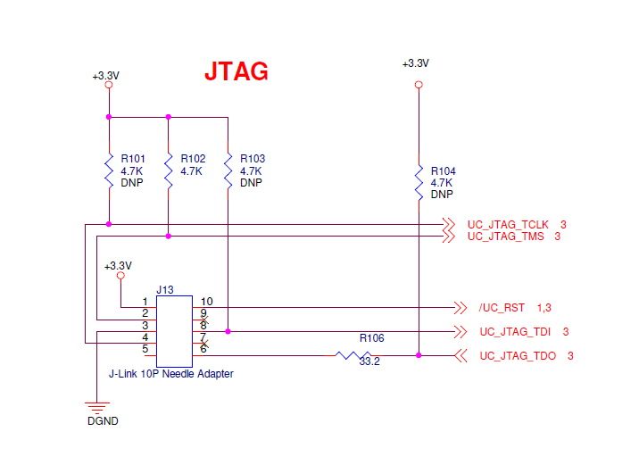

I use Jlink commander "unlock kinetis" but it time out.
There's only one 4.7k pull up resistor on RESET_b but it always at 30mV.

Hiya,
How are you connecting the other JTAG pins?

1043064987
Hi Myke,
Thanks for your notes. But when TMS is open, TMS is 3.3V. And after EZ_CS_b is left open, the RESET_b changes to 0.2V.(no longer 30mV)

myke_predko
Senior Contributor III
Hiya,
Can\ you put in a drawing of your programming circuit and the different signal levels?
Attached is the circuit I use for programming to the Segger JLink Plus (should be the same connections as you use) and the Segger Needle connector:
Just a couple of notes:
  • /UC_RST is pulled up and has a voltage supervisor on it.
  • EZP_CS_b is left floating
myke

1043064987
   Thank you. Finally, I solder a new one and it's all right. Maybe when I soldered the last one, temperature was so high and burn the chip.
