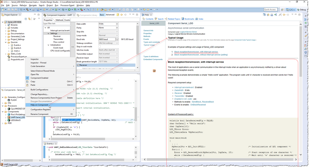

Hi everyone, i just tried a reception of a char by interrupt rutine (UART_OnBlockReceived), but it'n work, nthis is my code:

i attatch a screenshoots
Why interrupts no work?

hi, thank you very much, i've solved it, i didn't know "Help component" item.

Hi Ricard Comas,
Please refer the Typical Usage of Serial_LDD.
I have test it on FRDM-KE06Z board, the LED is able to toggle when 'e' is received.
