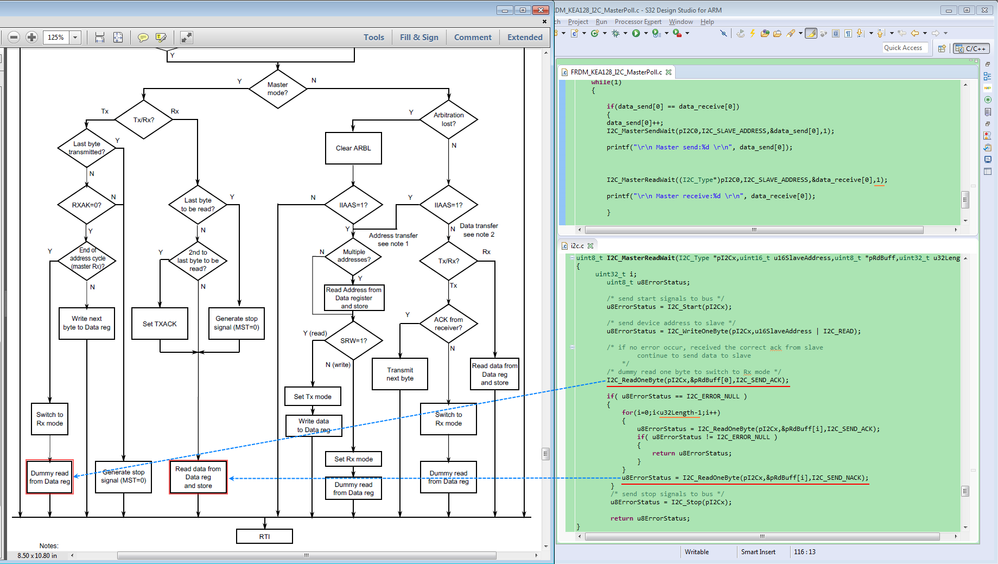

I'm using the KEAZ128 and I just downloaded the quick start package which has a bunch of test drivers in it. I started using the polling i2c driver and noticed that its reading two bytes out of the i2c register called instead of one? Has anyone else encountered this problem with this code?  Here is the read function from the file:

I2C_ReadOneByte(pI2Cx,&pRdBuff[0],I2C_SEND_ACK);

u8ErrorStatus = I2C_ReadOneByte(pI2Cx,&pRdBuff[i],I2C_SEND_NACK);

Please refer the "Figure 31-42. Typical I2C interrupt routine" in KEA128RM.
u8ErrorStatus = I2C_ReadOneByte(pI2Cx,&pRdBuff[i],I2C_SEND_NACK);  is used to read one byte out of the i2c register.
