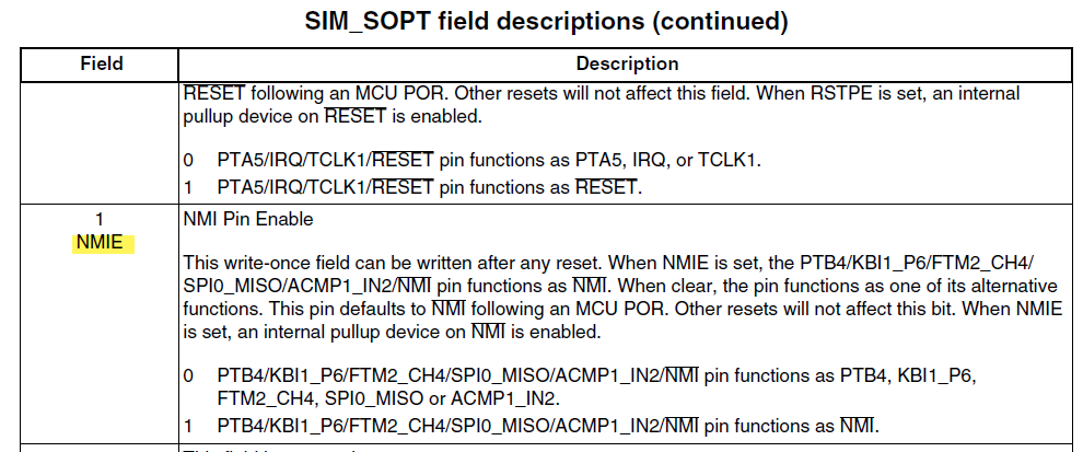

      i use PB4 as MISO. When I download the program to the MCU, it can work normally. But after re-power on, MISO no longer receives external changes. Then I transplanted the MISO function to PB3, and the function was normal after power on. Can you help me analyze where the problem is with the configuration?

Hi steetven,
The PTB4 pin defaults to the NMI_b function.
Driving the NMI signal low forces a non-maskable interrupt, if the NMI function is selected on the corresponding pin.
It is not recommended to use this pin for other functions.
PTB4 NMI_b.pngPTB4 NMI_b.pngNon-maskable interrupt.pngNon-maskable interrupt.png
If you must use this pin, you need to configure SIM_SOPT[NMIE].

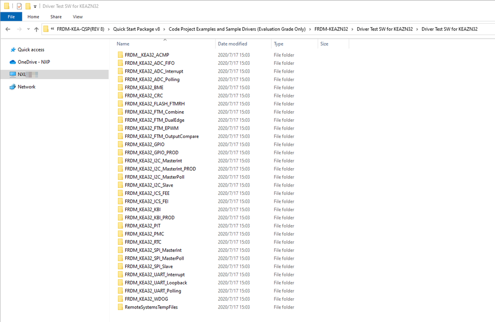

You can find examples in Quick Start Package for the FRDM-KEAZ evaluation board(FRDM-KEA-QSP). Please open these examples by using S32 Design Studio for Arm 2018.R1 – Windows/Linux
FRDM-KEA-QSP.pngFRDM-KEA-QSP.pngDriver Test SW for KEAZN32.pngDriver Test SW for KEAZN32.png
